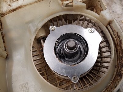

I did receive the kit from Saw Again (see post 4,855) , put the MS210C back together today. I had to use the pan from the original engine as the one supplied with the kit was wrong, but everything went smoothly after that until I tried to start it the third time...something in the easy start was slipping. I had to remove the easy start spring from the housing and reform the hook that engages the O.D. After that, everything was fine. That spring is pretty stiff.
The fit and finish on everything was very nice.
Mark
