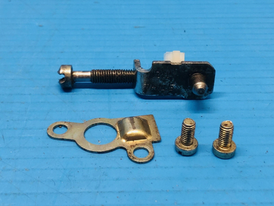

BTW...its got the old school tensioner like this....
Can I swap it for the newer version that tightens yer chain between the bar studs?
I believe what I've got is stripped...chain keeps coming loose after firing it up...

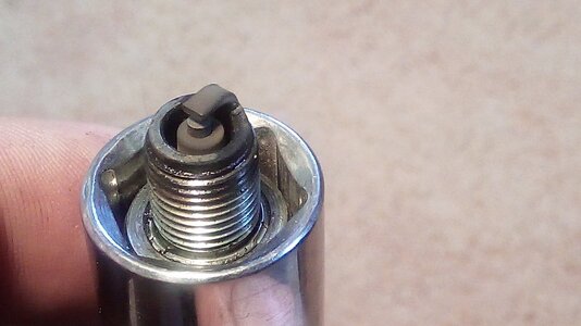

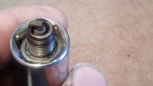

How does this look? Pulled it out of a 362 I had been having a hard time with until a couple members set me straight on tuning in the cut.

Can you post a picture of your crankcase in the bar pad area? It depends on which crankcase as to whether you can convert to the side-access tensioner.
Jacob, I most certainly would, except I have sent it sailing to Stump Shots Shop fer some repairs and modding.
I got my hands full tending to my 91 yr old Pa currently...
I appreciate the feedback though!:cool:
