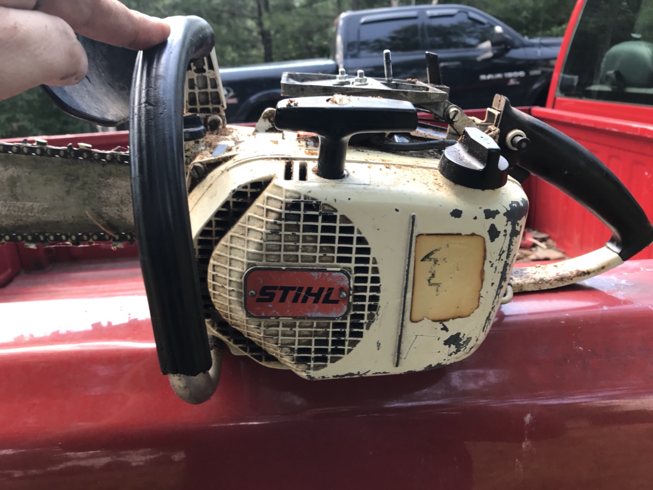

built this from the crank up. Can’t get it to fire up . Won’t get gas to the carb. Runs if I spray some two stroke thru intake

I bought a new rebuild kit and did the gaskets. New fuel lines and filter. Haven’t checked the impulse line yet

Working on it now. Taking tank handle off now

You can just pull the carb and drop a little oil into the impulse line to see if it draws it in with vac. May have a crack or split in it. May just need more prime, too.

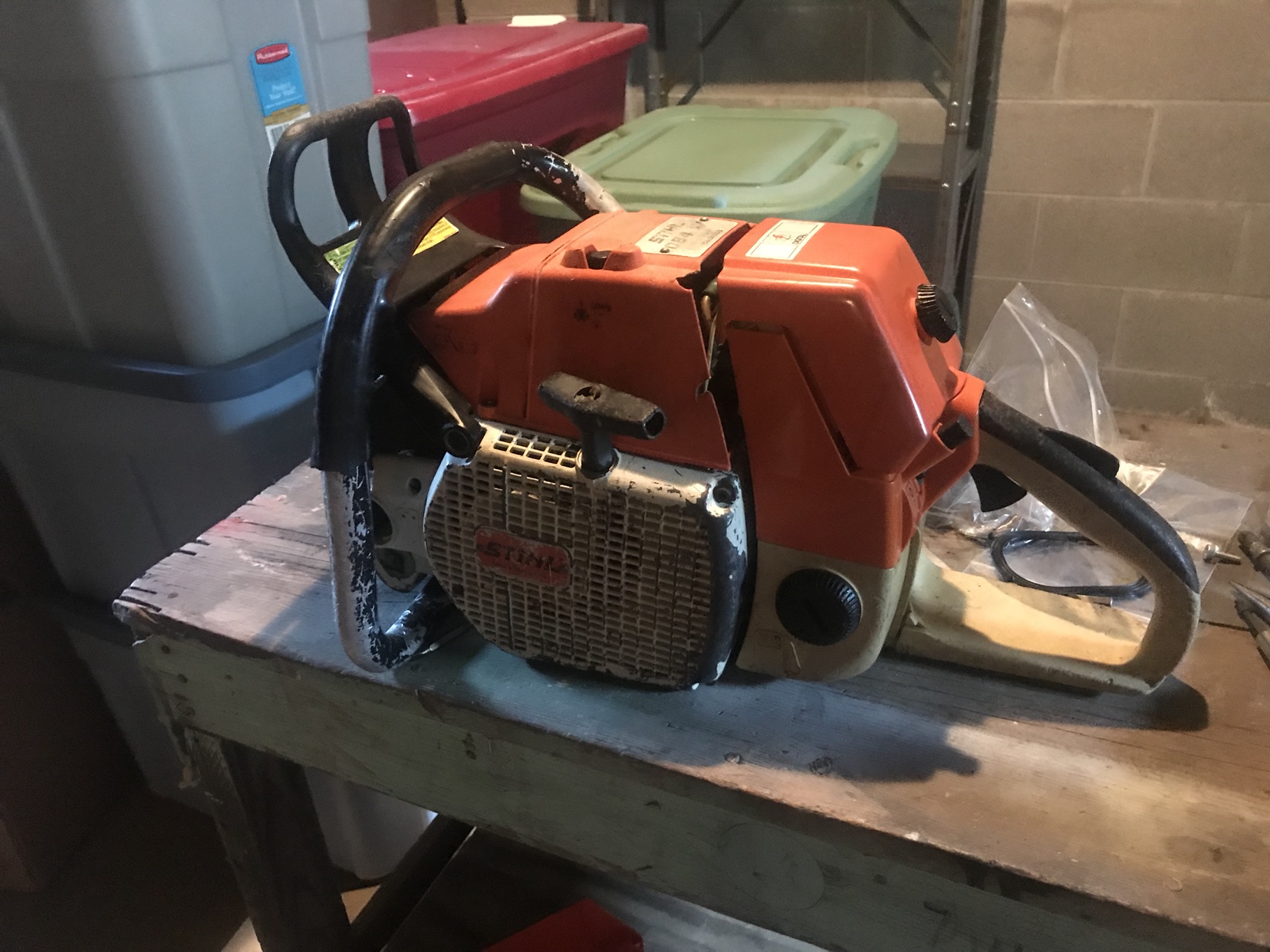

ADC0ABBC-0D11-4783-9AB0-B0E40C4A93F9.jpeg Working on switching a cylinder on a 362 because it tried to fly. Pulling apart and notice a Bosch plug made in China. I realize they are trying to save money but how much can you honestly save on a spark plug.
