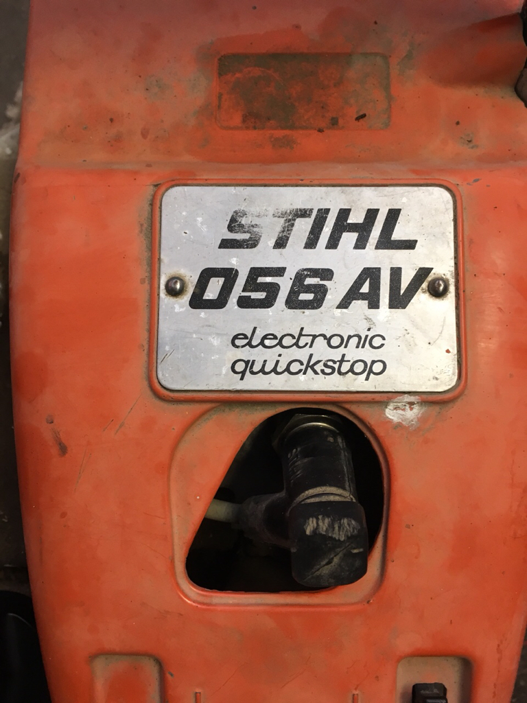

Where do the fuel tank connect to the carb? Can’t see a hose.[emoji848]
It have a ‘secret handshake’?

Got one here in a box I'll look at, too. It's a weird setup. Have an ancient shop manual that may shed some light. Pretty sure that elbow routes into the manifold bulkhead somehow and delivers fuel to the carb where the impulse passage would normally be. The impulse hose itself is pretty obvious. Let me dig around a bit...

Basically no fuel line to the carb, just a passage from the tank through the intake bulkhead.
If you need to remove the tank/airbox, (once the handle is out of the way), the a/v mount above the oil cap with the kill switch wire can be a mystery if all the rubber around it is still in place. It's threaded in to the case and does unscrew with a pair of channel locks . The other side comes loose from the center a/v mount screw.

OK. It’s kind of like the Remy SL-11 Tilly HS has a passage in the front face of the carb. [emoji106]
