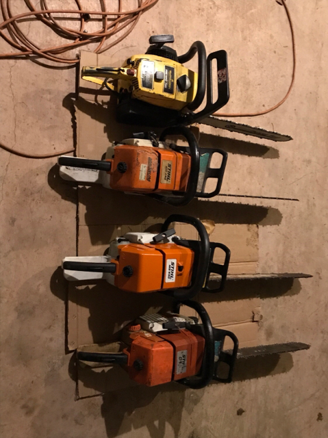

I got some 70cc saws to try out. I know one of them is yellow.

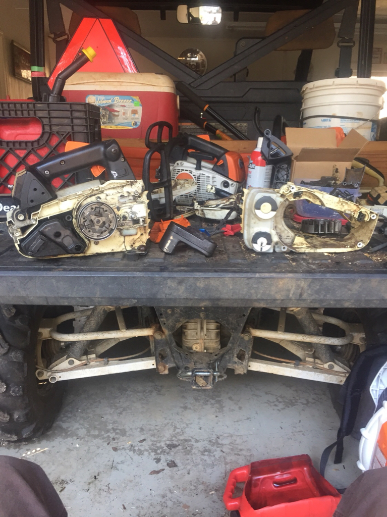

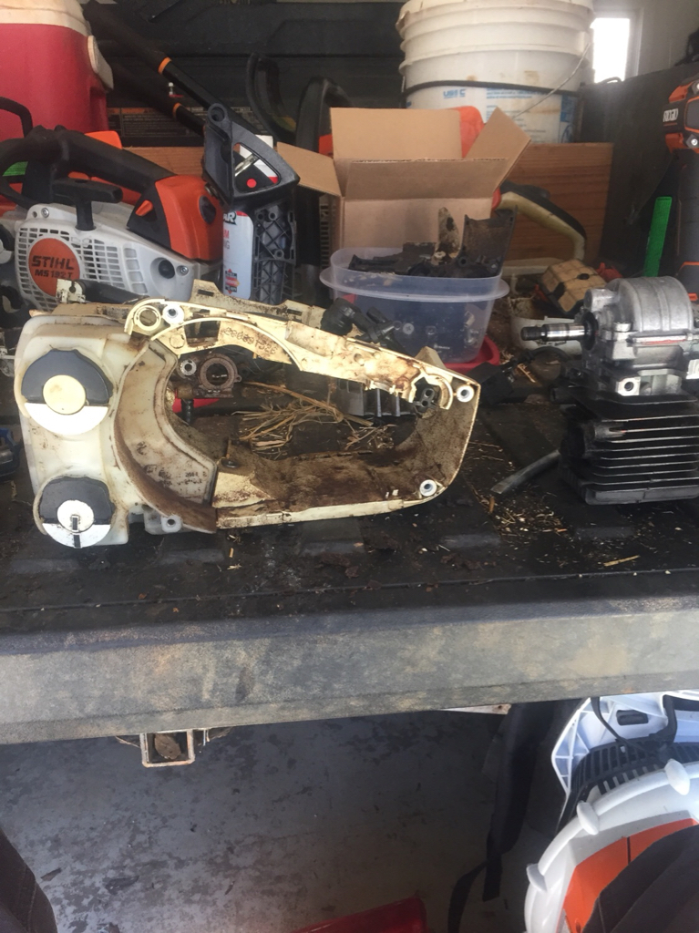

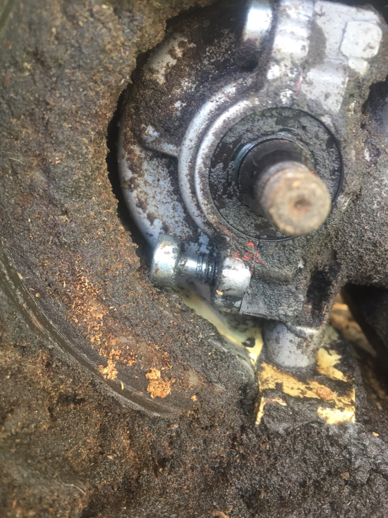

Picked up 2 ms192t on AS. Ones a runner, other needed work. Got to poking around and noticed the clutch was wobbling around... I thought the worst. Turned out all 4 bottom end screws were loose. This was the worst one.
Gonna do some handle swapping to fix the switch on the left one. Where the master switch went has been JB welded and smoothed over.
Already have the runner sold to a buddy once I’m done, the other will hit the bay.
Easy little saws to work on.
