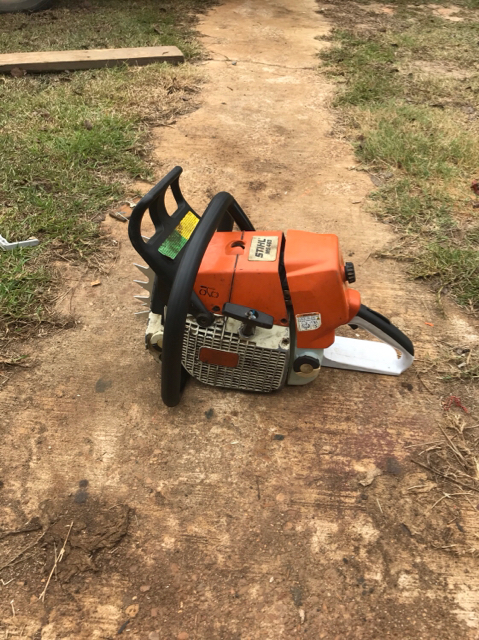

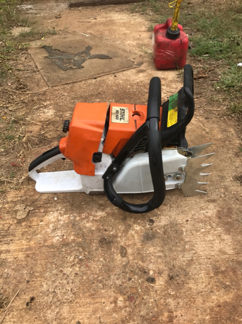

What should the base carburetor settings be on a MS460 with a dual port muffler. It ran good but I think I flooded it the second time I tried to run it. It put out a lot of blue smoke the first time I ran it.

I switched the aftermarket carburetor with a rebuilt oem carburetor. I should have known better than to try a cheap carburetor.
What carb did you try and where did you get it from?

I don’t remember exactly where but was from some independent seller on eBay, I think it was hi lo carburetor. I had good luck with the first one from that seller. The lever on the needle have been set wrong, I didn’t look, I just swapped cleaned an oem carburetor. The saw wouldn’t idle with the Chinese carburetor, it kept going dead.
