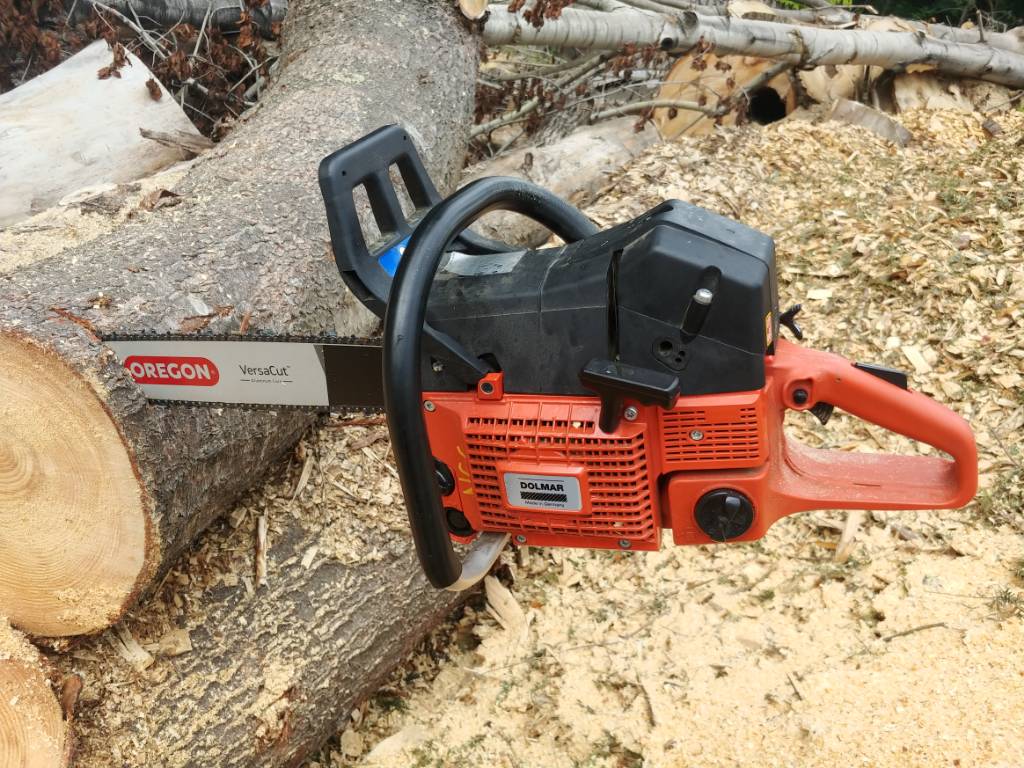

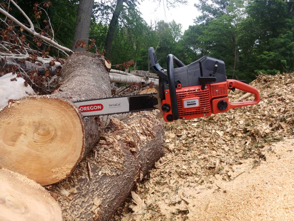

Why does it look so much like a Hooskie 2 series saw???
