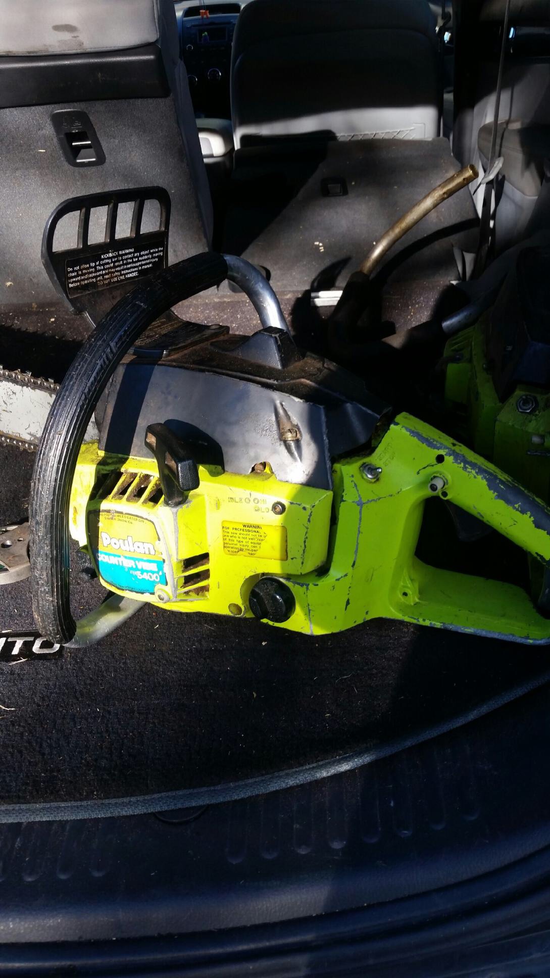

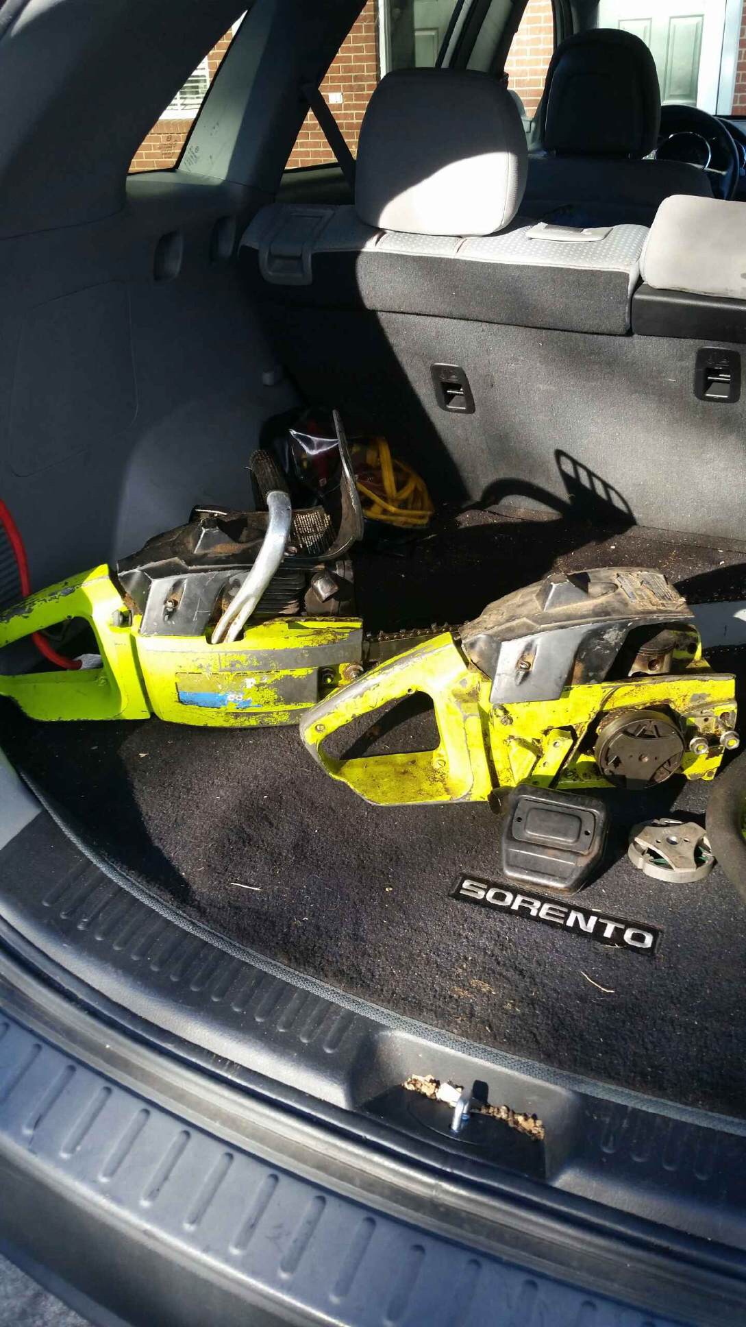

Lucked up and got me a 5400 today. I’ve had several of the in various states, but never a complete runner. Glad to get this one for sure. Had some good help picking it up for me.
I really appreciate you letting me have the mostly complete parts saw that came with it. Can't believe they were both right up the road and I never seen them lol
