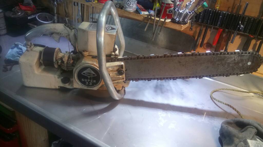

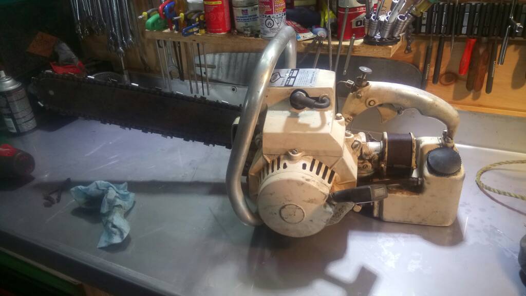

Doesn't run yet. But here it is

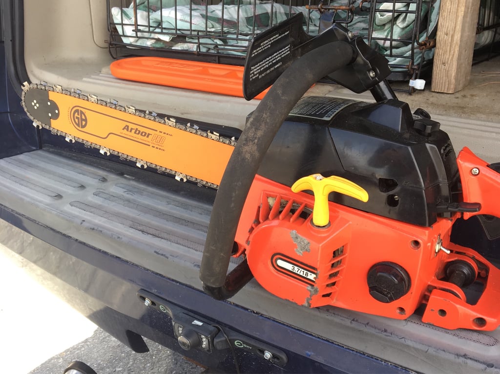

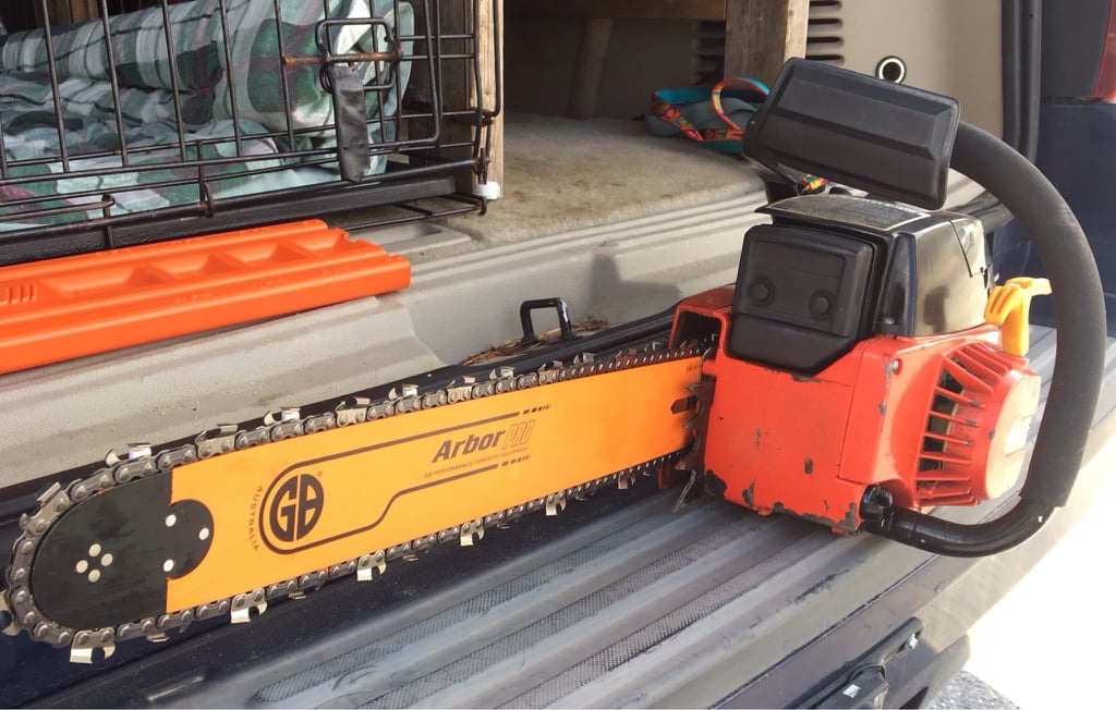

So when fitting a d009 bar on a d176 mount poulan 3700, u need thin spacers (i used thin springs) and a 67dl chain. 68 fits but very limited on adjustment

Nice a bright Homelite handle, can't miss that in the dark. Color coordination with the bar. I see what you're doing, nice.
