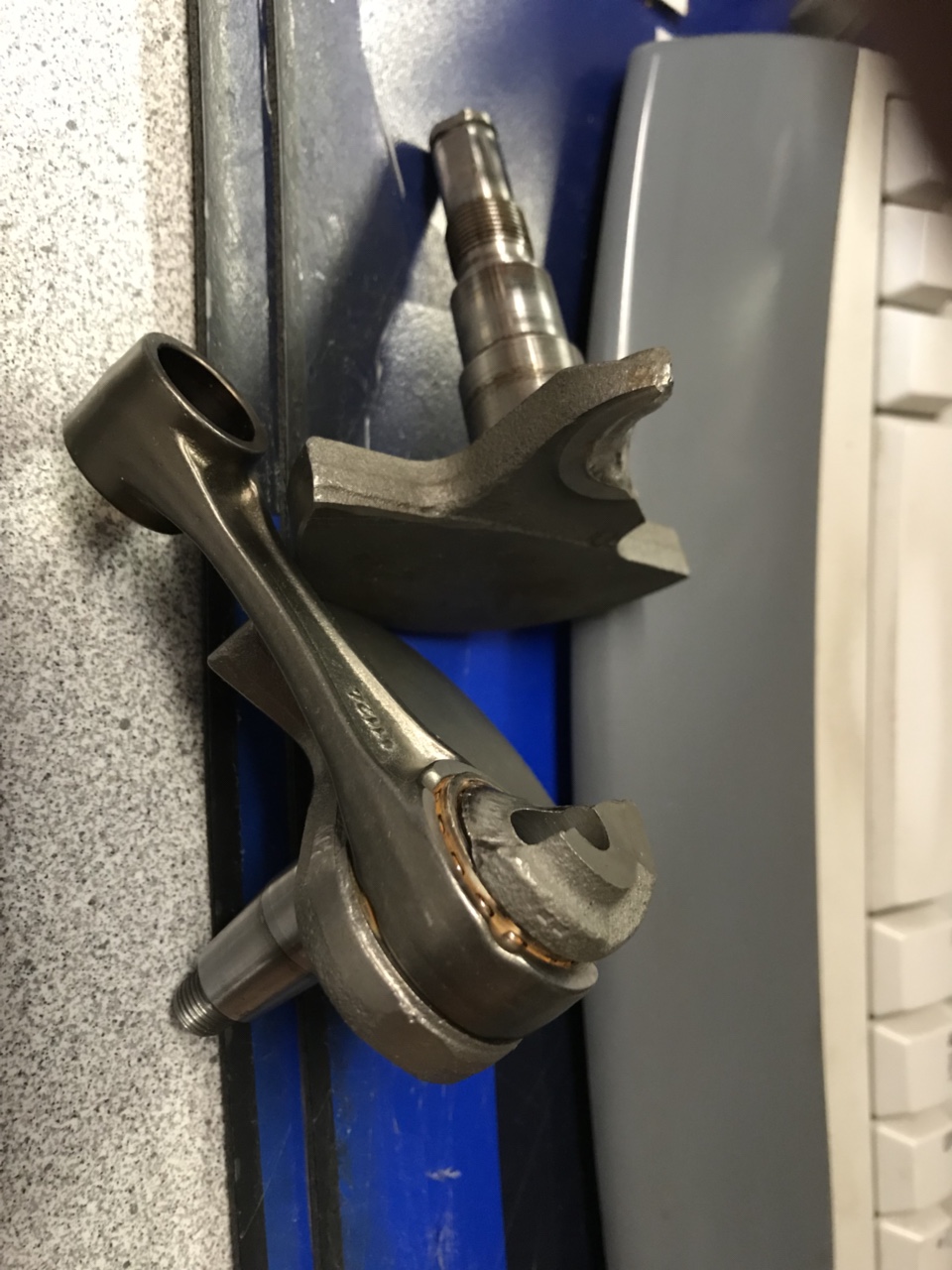

Here's a interesting one. I bought the saw this way.
That is an interesting one !!!!

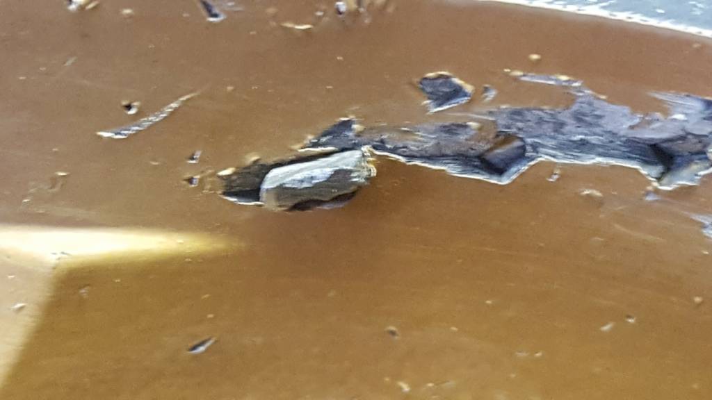

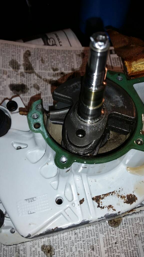

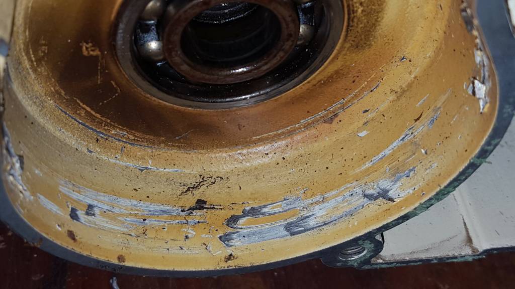

These 261 have about the best filtration I've seen. And.....the filter was good. Nice soft rubber seal.
I should have said improperly fastened instead of faulty because that's what I was thinking. I was basing this private detective work on the grime and crud all over the crank itself.

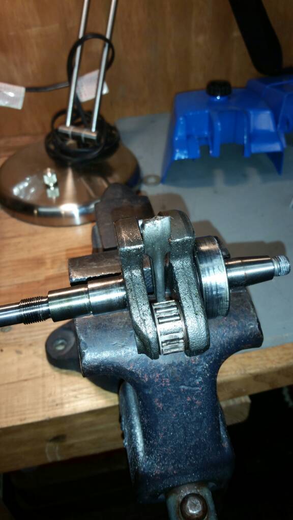

Anyone have any pics of the notorious solo cranks that went out?
