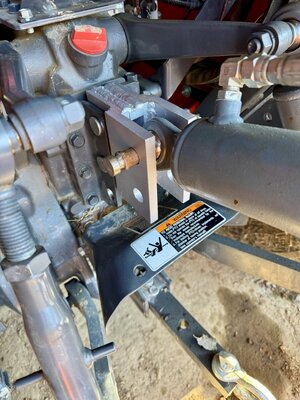

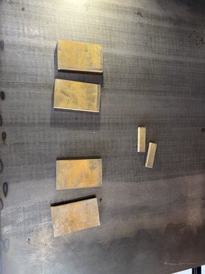

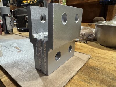

My next project.
I have Pat’s quick links on my Kubota and they add about 3.5” to the lower lift arm length. The tractor has hydraulic top link and side link so getting the 4” back on the top is $.
Saw this online and did some measuring and math and a buddy cut the parts on his water jet. I have em and will weld it up this weekend.
(I did the markup with measurements, it is based on my specific tractor)
Well I put it together today. Welder set at 200A, wasn’t particularly trying to make it pretty but it wasn’t too bad.
