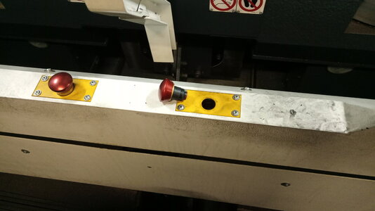

I have been assigned to man the beast this week.
So, while cleaning it at shift end I found one of the doors E-Stop shrooms broken.
You can clearly see that someone stepped on to the cabin to the right of the E-Stop switch and most likely knocked it out.
Gravity kept it in the hole.
Nice!

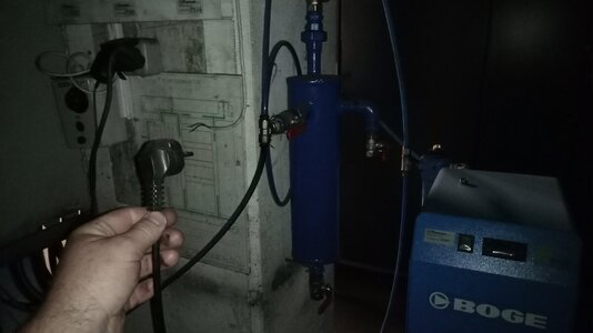

Then while shutting the machine down I went to shut off the compressed air supply and the dehumidifier.
Well, the first shift idiot manning the machine next to the beast pulled the dehumidifiers power cord and plugged in his cordless drills battery for charging.
FYI, both machines get their compressed air from that same dehumidifier.
The utter idiocy of the latter both amazes & disgusts me.

Is it humid over by you this time of year? You think the moisture in your compressed air, short term, will cause any issues?
8:07 PM
14,991
59,801
I snapped the red e-stop mushroom off this chip conveyor last year. Had to roll my toolbox past the machine and I caught the edge of the button with my cabinet riser.... But I went and filled out a maintenance request immediately instead of leaving it for the next guy.
At my workplace masking damage and not noting the same having the next operator think he broke it is common.
Our compressed air contains a lot of moisture.
With the compressors being near one end of the companies terrain and the mills on the other a lot of the moist settles as water in the pipes.
The parts of the machines that require compressed air are rather sensitive to wear (spindle tool clamping mechanism), water in said air breaks down the thin lubricant/oil film and causes oxidation, rough movement of the parts, and eventually seize up.
So far several machines required an overhaul of their tool clamping mechanisms, though not exclusively due to moisture in the compressed air but it played a notable role long term.
Every so often the operator opens the main shutoff air valve to his machine but fails to turn on the dehumidifier (which needs to be turned on first anyway, it is an A/C unit and its compressor needs some time to build pressure and cool down) - that first gust of air heading to the machine always contains a splash of water that settled in the pipe.

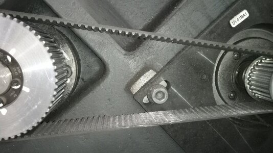

Operator: The machine (5-axis mill) is making a heck of a noise when rapid traversing.
Superior: Does it still run? Yes? Then STFU & run it!
Mill: Nope! KABLOOOOEYYYY.... How do You like them apples?
Operator: Boss, the machine don't run no more!
Superior: Stupid a$$ crap of a machine!
The belt don't look too happy! 🤣
