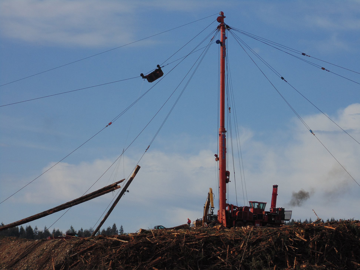

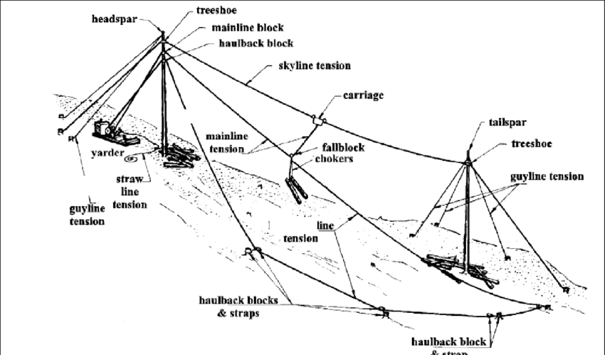

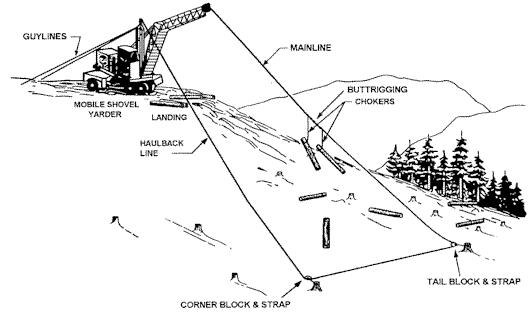

What are the down guys anchored to?
Typically, the rigging crew notches several large stumps for tailholds and may have an intermediate support rigged along the way, depending on the type of yarding they're doing.
Skeans can explain it a lot better than I can - I've never worked the rigging before, I've only cut on high-lead sides and most of that was straight-falling.
