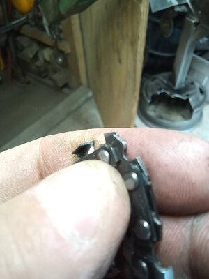

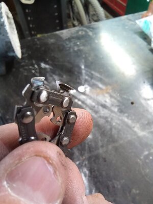

I figured I'd update this with my limited experience, after only a couple chains. These white wheels are definitely harder than the green ones, by a long shot. I sharpened a 28" 3/8" chain and a 12" whatever Echo top handles are and didn't dress anything beforehand and even with dirty chains (I didn't ultrasonic clean them) I didn't get a clogged wheel. I still don't need to shape the wheel, which I usually ran a stone over the green wheels before I started and then after each side, with a 28" chain. The finish seemed to be a bit smoother, but I did notice a tiny burr on a couple cutters on the small chain. I'm sure I'm grinding at different angles, so that's probably part of it. These also seemed to run a bit cooler than the green ones, which, I'm sure the wheel not loading up, is a large part of that.
I used a different grinder, my Tecomec Jolly Pro, one grinder below the Super Jolly and honestly, I prefer the manual chain tensioner to the hydraulic auto tensioner on the Super Jolly. Just a side not of the experience. The Super Jolly sometimes "bucks" the cutter up, as I lower the wheel and the clamp does it's thing, but the manual one is much more rigid. So, even though the wheel is designed to be a better finishing wheel, than the green one, I wonder how much of that is just the rigidity of the grinder. Next go around I'll have to swap these wheels to the Super Jolly and see my results. Ultimately I wanted a grinder set up with white wheels, and one set up with CBN wheels (which I have, but have yet to try........next chain I'll do that).
Lastly, I tried for 15, or 20 minutes, with both a phone and a tablet and could not get either camera to focus on the cutters up close. By the time it'd focus, I was holding the chain dang near 2 foot away and ya couldn't see anything. I'll mess with it later and see if there's a setting that makes up close pictures work better or not. Sorry.
Ultimately, for how not real specific as I am, and basically just wanting a wheel that lasts longer, doesn't clog up and doesn't need dressed constantly, these white wheels are the ticket. For only a few bucks more than the garbage green wheels, I'll buy these moving forward. I'm very happy with them. Can't wait to compare to a CBN and see if those are worth 4 times the cost.
Try holding a white card or paper behind the cutter when taking photos.

I didn't try paper, but I tried cardboard, my table, and my plywood wall. I'll try that next time. I found a couple places where the lighting was just right and it focused long enough for a couple shots.

Tips for taking pictures with these dumb smartphones:
- ensure good natural light, forget LED or Neon it messes with the camera
- You need a single color background as close to the cutter as possible, I found that black works best for my phone camera
- on my phone "tap the screen where the cutter is seen", my phone will zoom into that particular spot but not for long so take a shot quickly once the lense focusses on the cutter
- always take 2 or more pictures of the same thing, that way You can sort out the bad ones and hopefully have one that is good
- get a third hand to atchieve all written above
- get a comfy chair and a drink so You can sit and calm down when all the above fails, then try again

😂😂😂 That was pretty funny! I felt this post. My tablet has the "touch the screen" feature, but I couldn't get it to do it's thing, BUT I was using LED lighting.
Thanks for the tips Wilhelm. 👍🏻
