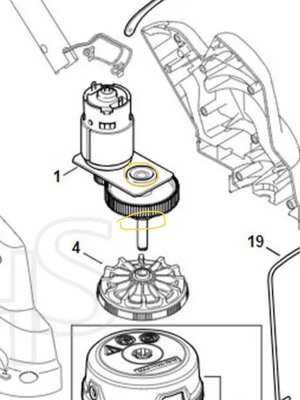

Just a general question really about stihl battery strimmers and possibly other stuff. Using wrong bearings in the wrong place.
The problem was fsa 57, it starts for a few seconds and then cuts out. It’s not the battery.
Upon closer inspection. The bottom bearing on the geared drive shaft of the motor had seized, marked in yellow in pic.
The bearings top and bottom are 609 2zz c3 . The motor needs cool air and this is supplied via the sort of fan #4 in the pic.
Imho Which in normal use here in the uk will supply damp moist air.
Spoiler, an email to stihl asking why this bearing is used and not a 609 2rs c3. They completely ignored the question and said battery strimmers should not be used when the grass is damp or wet conditions.
I pulled the Seized bearing and replaced it with a 2rs c3 , it’s a £3 inc postage where as the whole unit #1 is £85
I believe this is not the first case as another friend had a similar problem (I never looked at it, it’s what he told me) and the stihl dealer said they don’t repair them. But you can buy another strimmer @ £145..
Anyway here’s the pic etc.

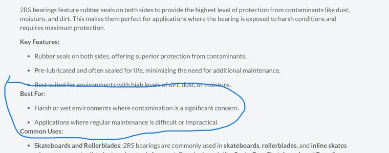

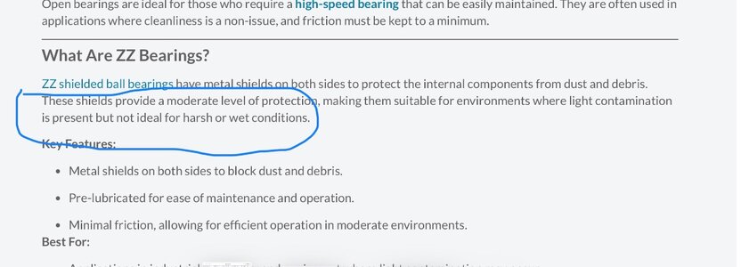

I was reading about the drag aka resistance etc of the different bearings 2zz & 2rs. however there is always an answer !.. but it cost more .. lol 😉😆👍
It’s called 2ru.
I’m sure you already know the 2ru shielded bearings are as good as the 2zz but less drag than the 2rs . I think it’s really a manufacturing issue cost rather than the cost of the bearings.
