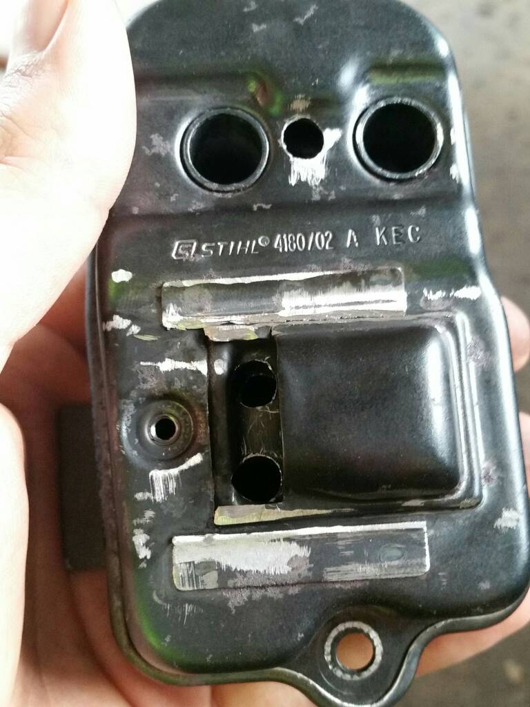

The trimmer only reacts at the very last point of adjustment, on the lean side, i think. How did you do your muffler mod? I think the excess of carbon on the valves and piston may have come from a stuffy muffler.

Ain't nothing fancy, but it works. ...the top comes straight out of the exhaust port. The muff is baffled throughout, so I drilled a couple lower by the original port.
