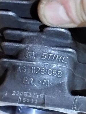

1st cylinder I ever seen these markings on cylinder. My guess is date and time of production or maybe tested.
