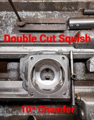

440 BB Test Cylinder. Took .050" from the band, added the taper... waiting for the new piston to arrive, match the x-fers and exhaust roof to the piston... hoping to get the exhaust floor matched as well... like some of the old homelites, etc.
