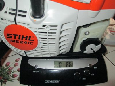

I had both problems with my 241. Bad throttle lag/dying during idle, and then lately it started to run richer and richer and richer until the plug was fouled, and this after getting the carb replaced out of warranty, and resetting it often. I gave the saw to a friend of mine after making sure he knew it was cursed. I just got tired of it.
00wyk
3:06 AM
4606
Nov 16, 2017
1,616
9,227
Ireland
And since theres not a Swedish watch in that size that's newer I have the 241 :).
Edit; that I like.

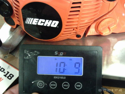

I was looking at alternatives and actually ended up replacing it with an Echo 360WES(had my name in it anyways, so why not). I have a dealers account with a large supplier in the UK, and I got it for less than half what a 241 is. No, not quite as powerful, but weighs 2 lbs less and gets the job done. But another alternative which was very tempting was the 50cc offer from Echo. No electric carb, and 10cc bigger...but what caught my eye the most was the weight.
Which echo is that in the picture.
The Makita 4300 is a great alternative, I like mine.
What do you think of the 360 Echo? How's it compare to the 241 for smaller work?
I've been eyeing the Echo 361P. Or the 2511T. Tempting. I do like the 241 but the weight savings over my 261 are pretty small.
