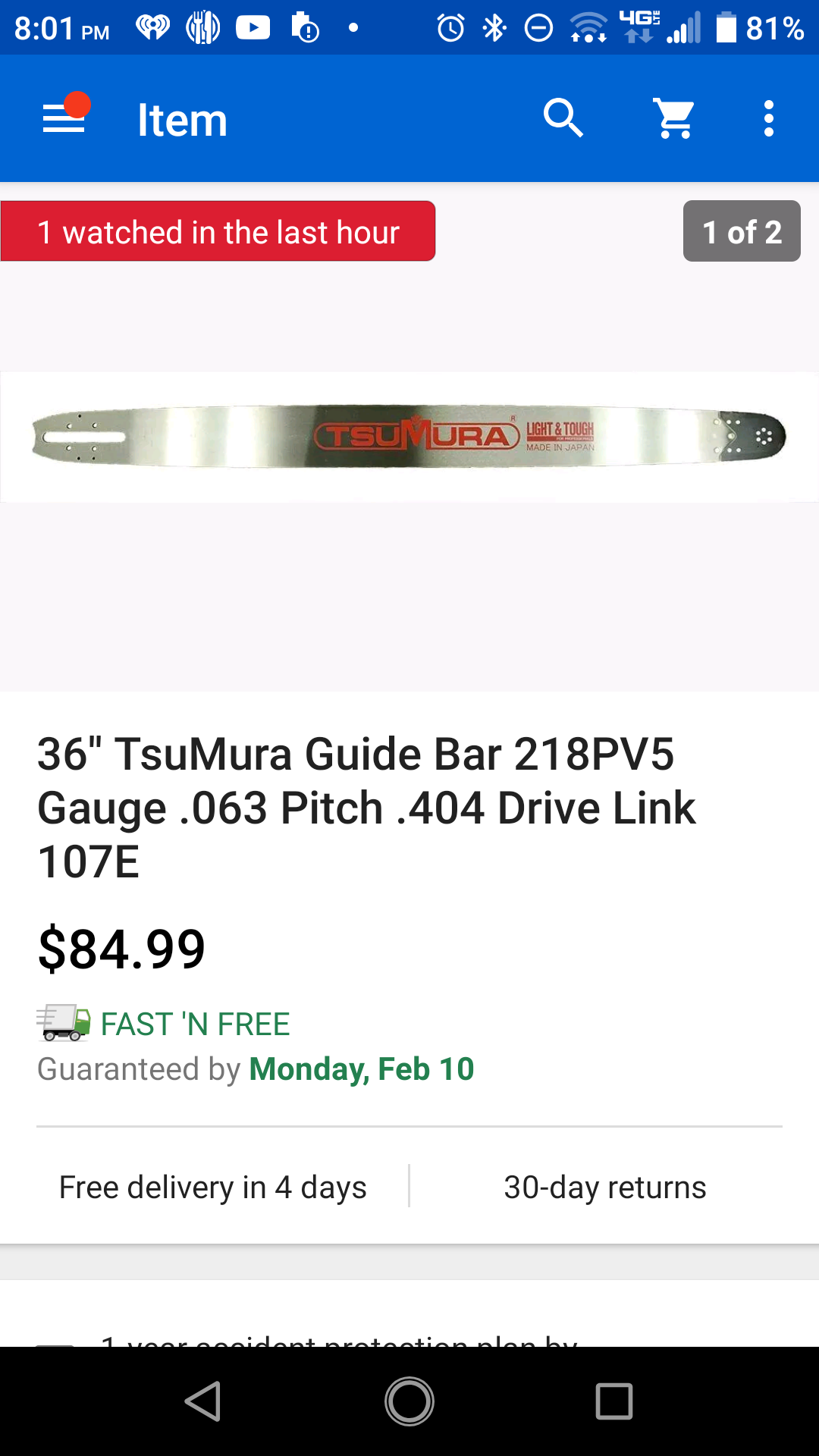

Setting up my 051 with a 36" Tsumura bar. I cut a mix of hard and soft woods that are sometimes a little bit dirty from being on the ground. What would you guys recommend? Full skip or full comp? The 051 is 89cc and it's setup with a .404 7 tooth spur sprocket. The bar is .063 gauge.

Dang. I just went looking for that bar to buy it and it’s gone. Guess I was too slow.
