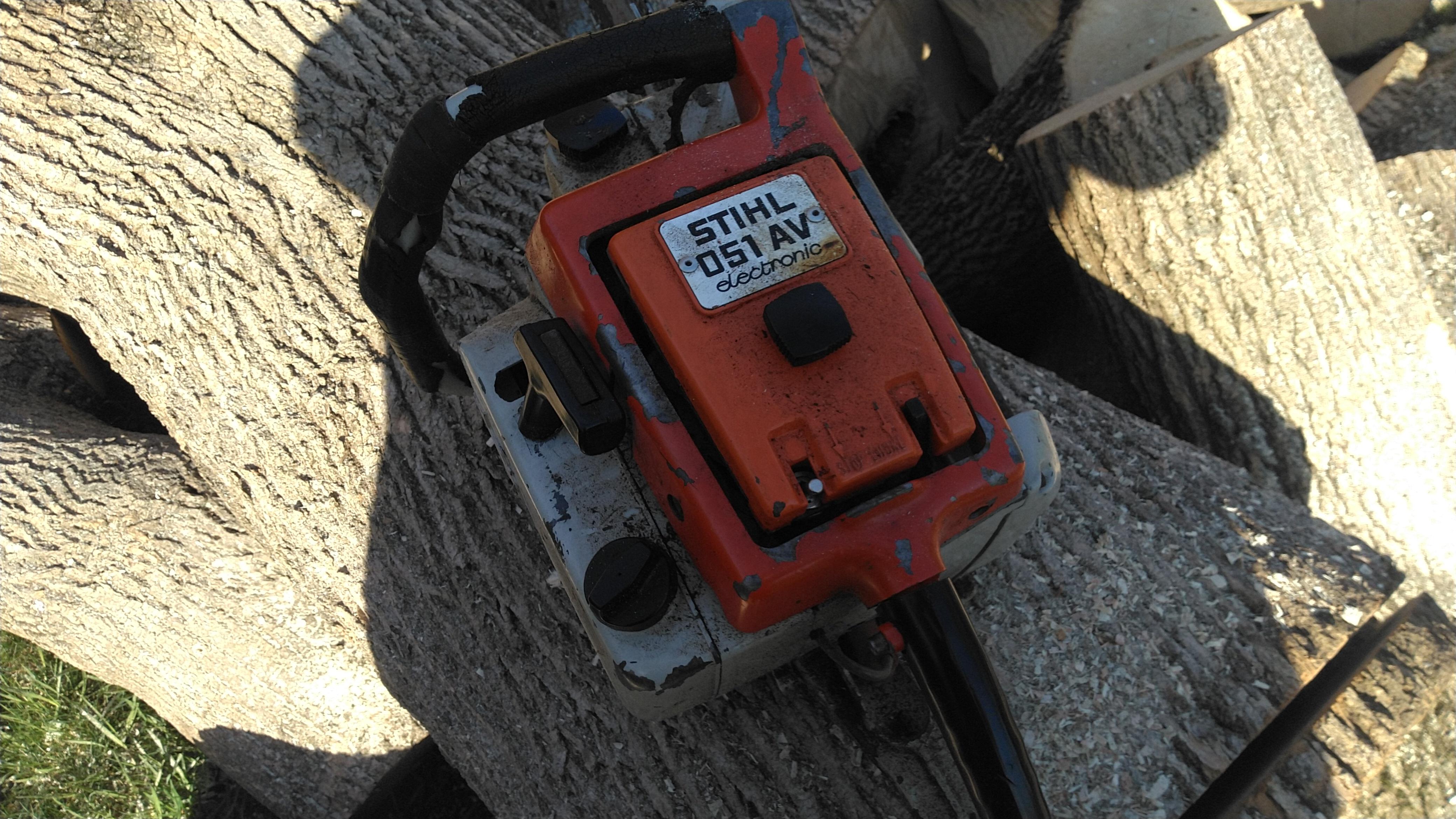

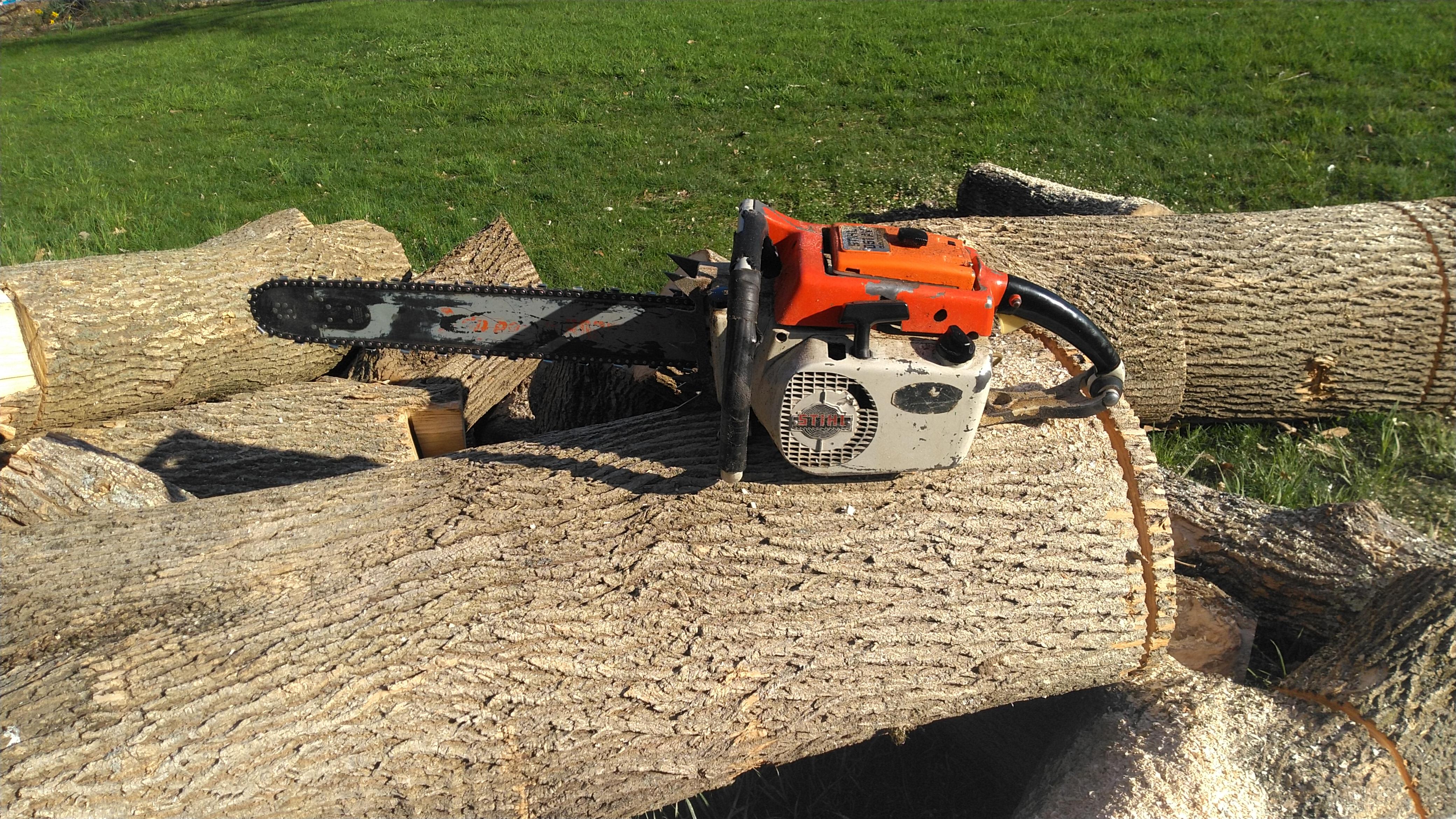

I have a nice running 050/051 that I plan on using for bucking up an ash that was dropped at my house, saw is currently setup 21" .404 .063, was planning on getting a 30" .404 .063 for it. Any reason it won't pull it? Unfortunately I don't have the option to convert it to 3/8 as the clutch drums/sprockets are getting hard to come by.
