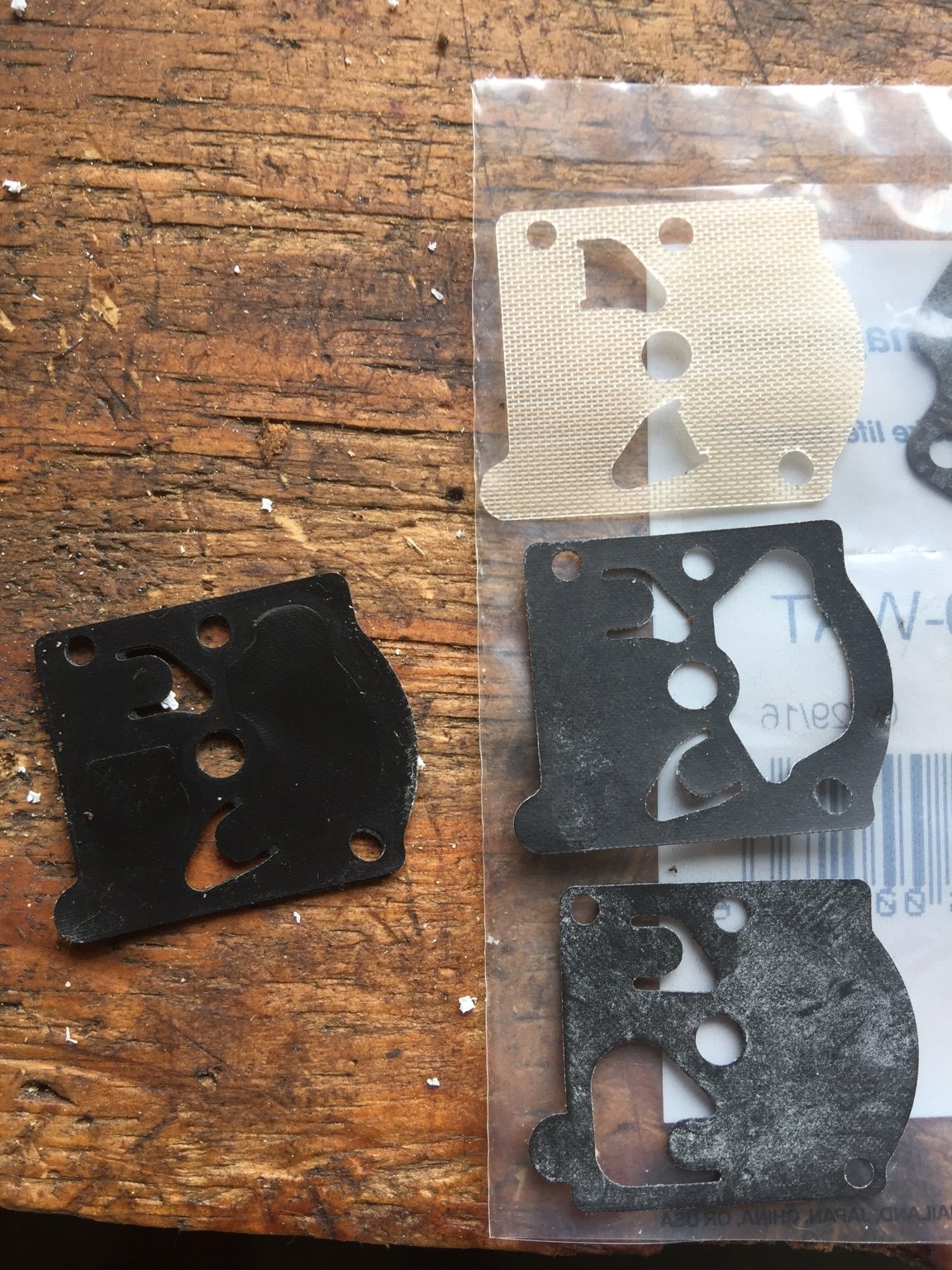

I was wondering about this a few days ago. I replaced all the parts in a carb, and was fumbling around with all the extra parts trying to figure out what they were all for. I used the blue one, but there was another, thinner tan one with lines in it like it was fiber reinforced. Does that tan one work better? Easier starting or something? If need be, it's a 10 minute job to swap it out.

The tan one would be my choice (if it fits) , otherwise use what does fit .
They work as well as any but I feel they stand up better over a long period .

Make sure it is exactly like the old one. The kit I got, the tan one was different
That's what I ran into too now that I look at it again. The old one is on the left. I would have to use the top two on the right to get the same thing, which is why I went with the blue one.

None of those look the same to me...
Right! The blue one was the same. It's what I used. The bottom one is different, and you'd have to use both the top two to get the right holes filled in. One has the little flaps, but the big section cut out. The other has the big section filled in, but no flaps. The blue plastic one had both.

most common carb kit the K10-WAT
almost funny every saw i own uses the same kit.

I use whatever fits when I build a carb. I use the tan, black rubbery one, or the blue plastic one. That is my order of preference.
use the top 2 on the right instead of the blue. black first then tan then gasket. blue is too stiff and most won't ideal right

Ok. I'll swap it.
