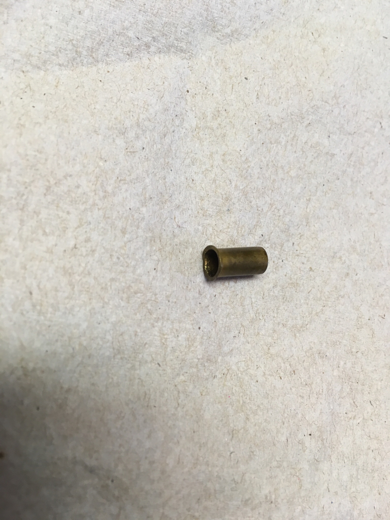

Hose end at the bar mount gets this little piece of flaired tubing.
Or, a goober of 3M weatherstrip adhesive works.

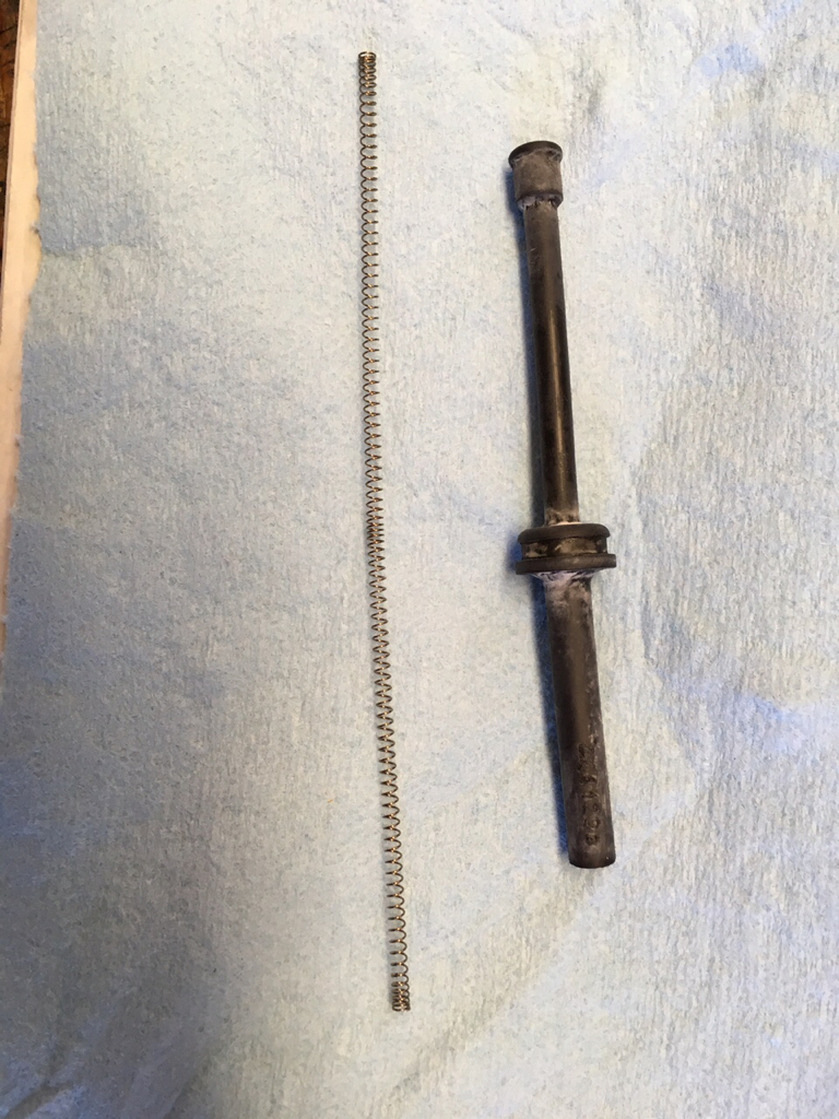

A spring should be inside the old hose to eliminate kinks.

There ya go. That's what I needed to know. I have a few of those flares and sure I can find a spring or a piece of wire. I don't believe that to be the hose. It would have no reason to have the grommet its all internal.

The hose I ran into on one that I was restoring was too long and that's what caused it to kink inside the tank. I clipped a half inch off of it, reattached, and she oiled fine after that.
I use the spring inside oil pickup lines to solve kink or collapses.
Above hose is a 200t. They are problematic. [emoji2955]
