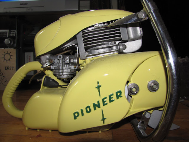

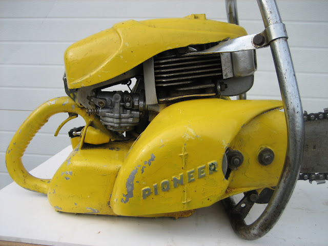

Why don't manufacturers use this engine orientation? Everything new, aside from top handle saws, looks to be pretty much the same.
The vertical cylinder is supposed to be better for compactness of the body, possibly better for airflow around the cooling fins plus the newer saws run with higher RPM that equals more heat generated. By arranging the cylinder in a more vertical position the rear handle could be isolated from the chassis, the separate fuel tank and a rubber mounted carb really helped with preventing the fuel from boiling and thus less chance of vapor locking the engine. With the front mounted muffler more heat could be shielded from the crankcase, really helps when a saw is run in a hot climate.

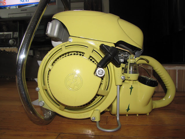

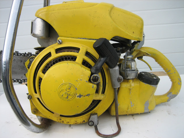

Man I just love them see through glass fuel filters on the big bottomed Pioneers. I want one just for that alone! Very nice saws Basher, you have clearly put in the hard yards.
Thanks, it took a few years.
