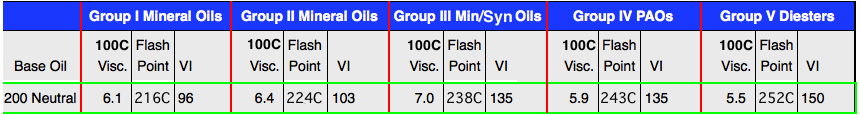

OIL TYPES- First we need to change how we talk about types of engine oils. Realize that the descriptive term "synthetic oil" has basically lost its meaning thanks to a court case that allowed oil manufacturers to label highly refined petroleum oil (group 3) as synthetic because it is nearly as good as true synthetics.
There are 5 groups of oils: 1. refined petroleum oil, 2. moderately refined petroleum oil, 3. highly refined petroleum oil, 4. PAO synthetic oil, 5. ester synthetic oil.
So an oil that is labeled as "semi-synthetic" can be highly refined petroleum oil or a mix of synthetic oil and petroleum oil. So it's now a very non-specific term. I prefer to understand the qualities of each type of oil and then read the oil specifications to know exactly what is in it. On this page you can see what is in each oil. Oils not listed here are ones that don't publish the oil specifications or are ones not very popular or not very good.
OIL TYPE RECOMMENDATIONS- I recommend a group 3 oil or a mix of petroleum oil (group 1/2) with true synthetic oil for air cooled engines with iron sleeved cylinders because they need higher amounts of oil for best ring protection and power. For high RPM racing engines I recommend any oil with high amounts of castor oil such as Maxima Castor 927 although it requires more frequent engine disassembly and cleaning of the ring grooves. For water cooled engines with power valves I recommend group 4 or 5 oils for the lack of residues they leave on the valves.

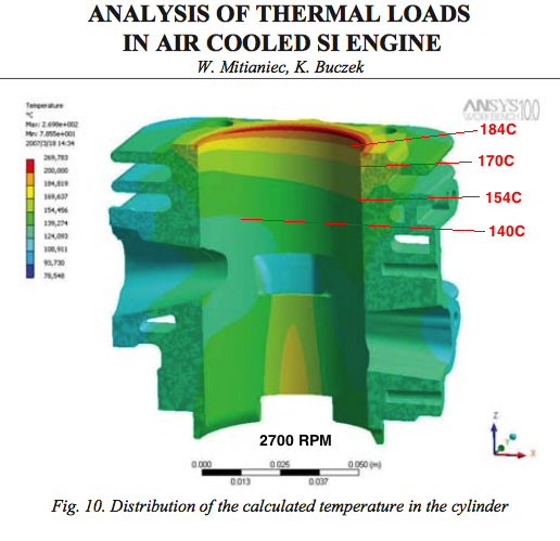

Flash Point Temperature: The temperature at which the engine oil can vaporize and burn. The higher it is the more oil will stay on the hot engine parts (especially the upper conrod bearing). The more oil that stays on, the more engine protection you have. But the listed temp doesn't reflect the flash temp of the actual base oils which are usually 215C - 300C except for group 1 oil which can be as low as 75C. So oils with significant amounts of group 1 oil need a lower fuel/oil ratio for more oil to replace what evaporates off engine parts.

The Different "Types" of Oil
There are basically two different types of oil available. We have straight mineral based oils, straight synthetic oils, and something called a semi-synthetic which is a blend of the two.
Mineral based oils are generally known for good lubrication properties while the engine is running and then, while the engine is sitting between flights, the mineral oils do a great job of keeping the internal parts of the engine coated with a fine film that keeps rust from forming. However, there have been complaints about excessive carbon deposits and excessive smoke when straight mineral-based oils are used.
Synthetic oils are generally known for having excellent lubrication properties with low deposits and they can be used at higher fuel/oil ratios (for less oil) because their viscosity and viscosity index, and flash point temperature, is higher. Let's define "synthetic." Where traditional mineral (or conventional) oils use refined petroleum, synthetic oils consist of chemical compounds that are artificially made by breaking down and then rebuilding petroleum molecules. The end result is an oil containing specific molecules that are tailored to provide optimal lubrication properties. These are the group 4 and 5 oils. Legally group 3 mineral oil is considered synthetic because its properties are basically equal to synthetics.
100% synthetic oil uses a synthetic base stock mixed with a variety of additives that boost the performance of the oil. While all synthetics on the market may offer a higher level of protection than conventional or synthetic blends, not all synthetics are equal. Each synthetic brand uses a mix of high-performance fluids and additives. How these formulations come together results in various protection levels and attributes.
The main difference between mineral and synthetic oils are the synthetics ability to maintain good viscosity when temperature rises to an extreme (evident by the higher viscosity index numbers).
2-cycle oil comes in two basic types: Air-cooled and water-cooled/outboard. The "air-cooled" type is designed for higher operating temperatures and RPM and contains a "low-ash" detergent. The "water-cooled/outboard" type is designed for lower operating temperatures and RPM, and contains an "ashless" detergent. Either type is not recommended for the other's application, due to various concerns. The type for water cooled low RPM engines leaves no ash since if it did then the lower engine temperatures wouldn't burn it off which would let it stick and build up on surfaces and foul plugs.
Which type oil for 2 strokes?
Often synthetic oils are compared to conventional mineral oils in cars which skews the results if you are a 2 stroke motorcycle rider considering which type of oil to use. That is because in a motorcycle using pre-mix the owner mixes in the oil with gasoline at different ratios but in a 4 stroke engine there is no mixing of oil with gas at different ratios. Of course the results would favor synthetics in 4 stroke engines but if a synthetic oil is twice as good as a mineral oil ounce per ounce then does it maintain any advantage if you use half as much as you would with a mineral oil? (50:1 compared to 25:1 gas/oil ratio) Keep this in mind, that 2 strokes have been proven to have more power the more oil is used, regardless of what type oil, because of better compression due to better ring sealing and less friction. They also are more combustible than true synthetics and so contribute to engine power. Mineral oils leave more top end carbon deposits and require more engine maintenance to clean off the head and piston top. They also create more smoke and leave more spooge (black gunk) in the exhaust pipe. That is their downside. Synthetic oils should be used in engines with exhaust power valves and in engines that won't be taken apart often. Also they have the clear advantage in 4 strokes since they break down at a slower rate (since the oil is "recycled" instead of being used temporarily in a 2 stroke). Another advantage of synthetics is they maintain more lubricity when there's high heat or cold. Their oil is more stable with temperature variations. But with 2 stroke engines if you do frequent maintenance and want the best power then I would recommend any good oil made with the highest grade petroleum oil which is group 3 oil. It is so good that legally it is allowed to be labeled as a synthetic oil. Unfortunately I don't know of any for sale in the USA. So next best would be a good semi-synthetic oil. If you choose to use a true synthetic oil (PAO or ester) then I would recommend one made with the ester type oil which is better than the PAO type synthetic oil.
While group 4 synthetics are better than group 3 for high and low temperature (oxidation resistance + pour point) characteristics, group 3 oils have higher additive solubility. So which oils have group 3? The only ones I have found are the Legend oils and Shell Advance Ultra 2T (not available in USA).
from an article written by Robert Verret:

The flash point temperature is better the higher it is because that indicates absence of group 1 mineral oil or absence of solvents. Also a lower flash point oil will lower the gasolines octane so the higher the flash point, the better. So if your engine is high compression and you are using high octane gas then you should try using an oil with a higher flash point (full or part synthetic) in order to avoid any possiblity of detonation. In the old days, when all of the two strokes were developed, they all used Castrol petroleum oil at a 20:1 ratio and found that 92 octane gas had the octane reduced to 72 with presence of that much oil.
A research paper used a 167cc 4 stroke engine with 6.6 compression ratio to record 250ºC at the piston edge @ 5000 RPM which could be projected to be 300ºC at 9000 RPM. The rings will be a cooler since they are farther from the hot piston center and they are the thermal conduit between the piston and the cooler cylinder. And the cylinder is gradually cooler with distance down from its top. So if we guess at the average ring temperature as being 200ºC on air cooled engines then we need to calculate for an engine oil viscosity at that temp for comparison of oils for use in air cooled engines. So for the oils that have their 40ºC and 100ºC viscosities listed then the 150ºC and 200ºC viscosities are calculated from an online calculator.

Here's an illustration from another research paper showing temps of an air-cooled engine at 2700 RPM:

API Group I and II base oils exhibit the same viscosity index range of 80 to 120. The breakthrough in producing API Group 3 oils (petroleum derived "synthetic") came when it was realized that severe hydrocracking would produce a base oil with a viscosity index above 120. This was now comparable with the viscosity index range of PAO synthetics. PAOs, categorized as API Group 4 base oils, are initially derived from ethylene, which itself is a colorless, highly flammable hydrocarbon gas. Esters, made from an oxoacid reacted with a hydroxyl compound such as alcohol or phenol, belong to API Group 5 base oils and have excellent lubricity and high temperature resistance. They are more expensive than PAOs and not commonly used as the base oil for synthetic motor oil but rather as an additive. Synthetic oil generally has lower levels of additives compared to conventional motor oils. Most notable are reduced quantities of viscosity improvers because of the inherently high viscosity index (VI) of synthetic oil. A high VI means that synthetic oil loses less viscosity when hot. Synthetic oil generally has a lower pour point so needs lower levels of pour point depressants [solvents] than conventional oils, which have high levels of waxes that solidify at low temperatures. The lower levels of aromatics also benefits the oil as lower levels of sludge dispersants are required. One additive that is necessary is a seal conditioner to ensure seals retain their elasticity and do not dry out, and additives are also needed to disperse products of combustion such as soot.
https://www.bizol.com/company/education/lubricant-knowledge-base/synthetic-oil/
