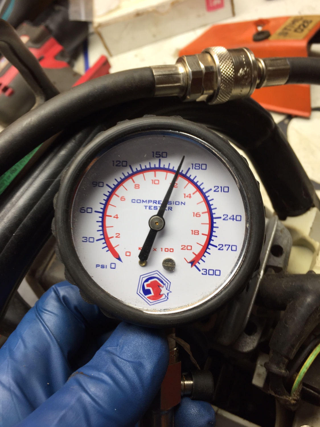

Questionable what the other end of this gauge is connected to.

‘Twas hooked to the saw I posted a pic of.Questionable what the other end of this gauge is connected to.![]()
When you machine a head it’s better to start with a small chamber and work your way bigger. It’s about at 180lbs now.

Very cool.460's are really strong cutters with 210 comp.
This is a warm reading after first time start with new rings. It should climb a little more after a couple good runs.
Here's how it runs with regular 3/8 chain straight off the roll.
Should be pretty strong at 200psi.View attachment 185843
