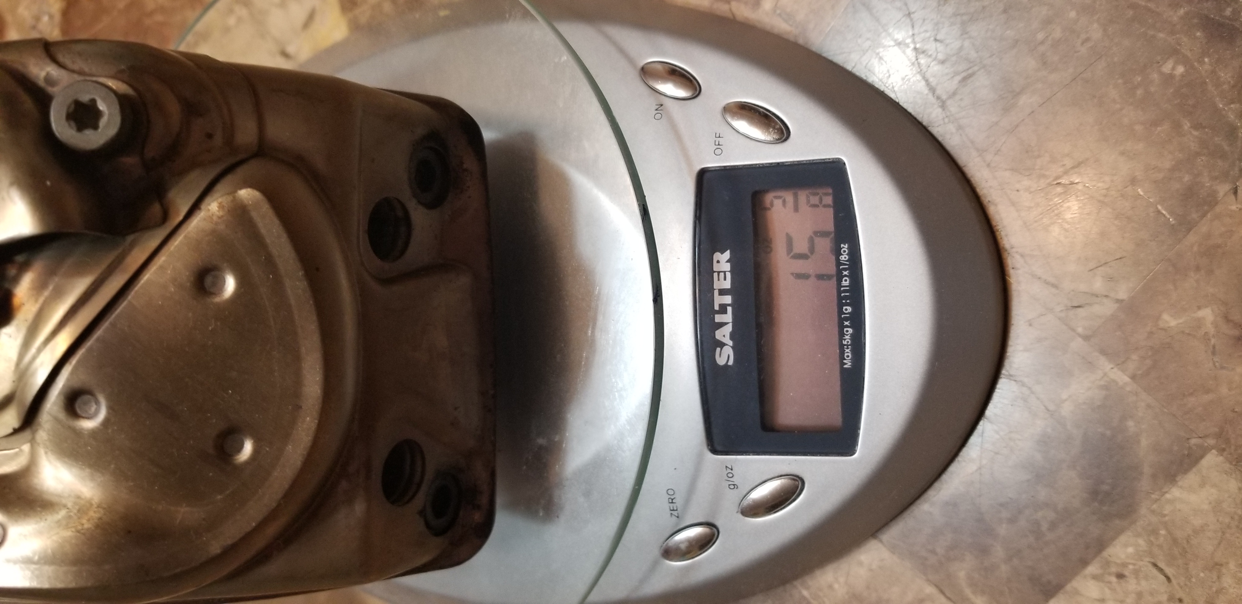

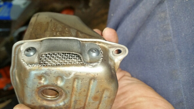

661c that had been ported with inside of muf matched and emptied. The hole w/screen had been left alone so...........20190810_170809.jpg
Picture window and some drilled holes in cover to cool the cylinder by letting hot exhaust out
