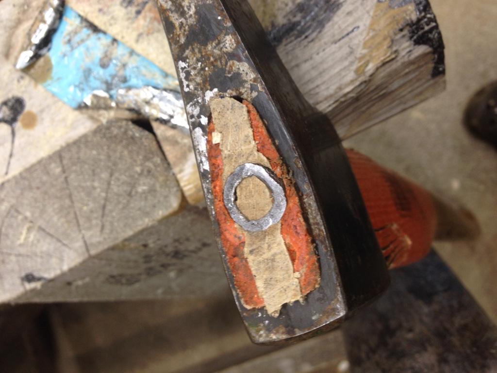

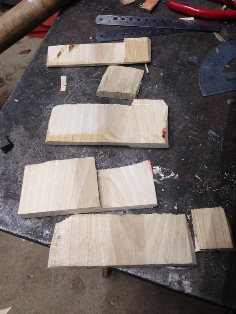

What are folks preferring for wedges? I have several axe heads to hang so will pull the table saw out and cut a bunch. I have most hardwoods to choose from -softer birch and poplar through hard maple and hickory with beech, oak, cherry, ash in between.
Well, it was not as easy as expected. I had a 12” piece of 3/4” x 6” ash I thought I would use. Measured an old wedge and set the table saw blade at 10* to match. Set the fence for 3/8” on the wide end and about 3” of wedge. It was more cut than my saw blade could handle. Lots of heat and smoke poured off the blade. Tried the chop saw instead but no safe way to cut a 10* angle through it.
Eventually I got some cut that I was happy with and rehung my Husky pickaroon head.
Looks nothing like the pro jobs you guys do, but it’s not loose anymore. And I learned what not to do next time.
I should have ripped the off cut into 3” wide strips. Would have gone better..

Belt sander!
I've made a BUNCHO wedges & always cut em & refined the angle with a belt sander!
