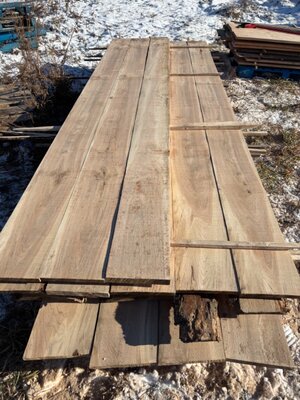

So I was told to get the sawdust off the boards or they will mold. It was 0* or -18*c on the weekend and the windshield washer and water mix froze the sawdust to the boards. How bad is it really?IMG_0075.jpeg

If you have them stickered well, wait till it's a little warmer and blow the boards off with a leaf blower. That will get most of the dust off, except where the stickers are. It molds worst when they are in a damp environment, like it they were covered with a tarp and couldn't breathe. Some mold on the boards isn't the worst thing if you're planning on planing them.
