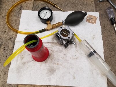

New member with a question. I'm working on a Honda EU2000i generator and was trying to think of a way to test a new fuel pump before installing it.
I need a pulse source to power the pump.

I was wondering if the fuel pump would function with a slow pulse. I see it would looking at the photo.

If you have a pressure tester, make sure that the pulse fitting holds vacuum or pressure. Also the outlet should hold pressure and the inlet should hold vacuum. That will show that the diaphragm and at least one check valve is good. If that is an OEM Mikuni pump they are very good.
This is my first time to work on a Honda generator. I've had an occasional bad part doing repairs, so I ordered the OEM pump. I didn't want to re-assemble the generator and find out the pump was bad. Good to hear they are good quality.
