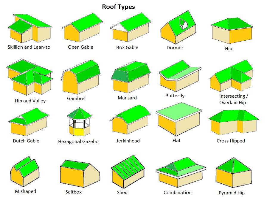

Do to my lack of carpentry terms, will the new roof be, I guess, typical trusses, so a peak running from one end to the other verses the center peak that it had?
This will help on your roof knowledge :)
Curious to see the trusses fly!
