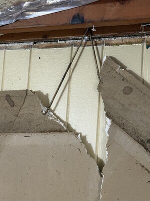

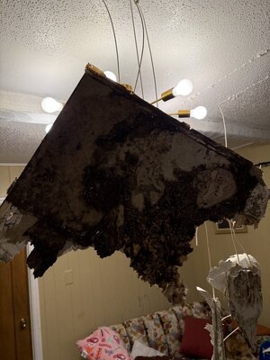

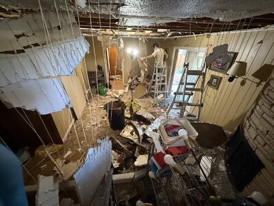

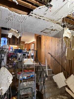

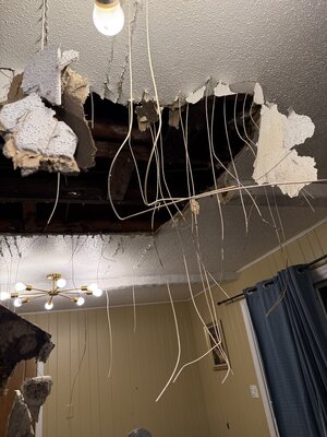

My friend called yesterday morning, has some issues with a toilet in his 60s vintage house. Went to cut some sheetrock out of the ceiling and and found this debacle. Never knew this existed. Went ahead and pulled the whole ceiling, we kept finding more issues as we went. Shocked his house hadn't burned down. There was melted insulation, burned up wires and scorch marks on the joists all over the place. Made demo a huge pain in the ass.

Good lord. I'm a builder and have never heard of radiant ceiling heat. Maybe electricity is too dangerous and never should have been made available to the masses. Like Edison tried to show us by electrocuting an elephant back in the day.

Low voltage to keep a pipe from freezing OK but trying to heat a house with the same kind of method. Am I understanding correctly?
Exactly, ai synopsis:
Radiant ceiling heat from the 1960s-70s refers to systems with electric resistance wires embedded in the ceiling, popular during a time when electricity was promoted as cheap and clean energy. These systems were known for being low-maintenance but are often considered inefficient and expensive to operate today, with common issues including thermostat failures, a tendency for the wires to be accidentally damaged by drilling into the ceiling, and difficulty in repairing them without attic access.
How it worked
Electric resistance wires: The systems used a grid of electric resistance wires installed directly between layers of drywall or embedded in plaster and then covered with popcorn or other ceiling material.
Thermostat control: The heating elements were controlled by a thermostat, often a simple mechanical switch, that regulated the temperature for each zone or room.
Heating method: The wires heated the ceiling surface, which then radiated heat down into the room, warming objects and people directly.
Common issues
Inefficiency: Electric radiant heat is generally more expensive to operate than other forms of heating like natural gas or heat pumps.
Damage from drilling: A significant drawback was the risk of damaging the heating wires by accidentally drilling or nailing into the ceiling, which could lead to system failure.
Thermostat failure: Original thermostats were mechanical and prone to failure, leading to issues like the system overheating.
Repair challenges: Repairs were difficult, often requiring access to the attic to locate and fix broken wires.
Comfort issues: Some users found the heat uncomfortable, as it would warm their heads but not their feet effectively.
View attachment 474642View attachment 474643View attachment 474644View attachment 474645View attachment 474646
So how did the project go?
Cleared all the sewer lines (previous owner was a wipe flusher) and replaced all the toilet seals. Hopefully that should take care of the water. Sheetrock hopefully comes next week and we're going to rock the ceiling the weekend after Christmas. Dude has 11 kids so nothing happens quickly over there.
