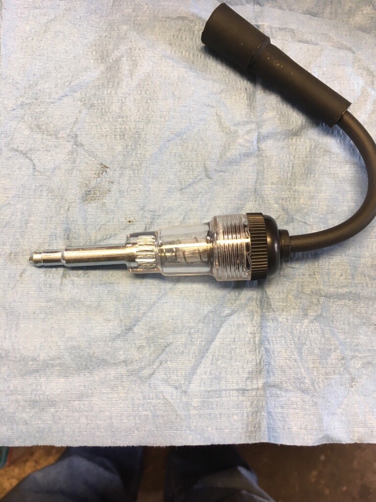

Ended up with this from O’Reillys.
One must really rip on the pull cord for the light to go on.
They also have the other types hanging in blister packs.

67L36Driver
9:44 AM
596
9,671
41,636
The above didn’t work on the 056 while running.
Maybe I should try at night.[emoji848]
On to the next from OReilleys.
