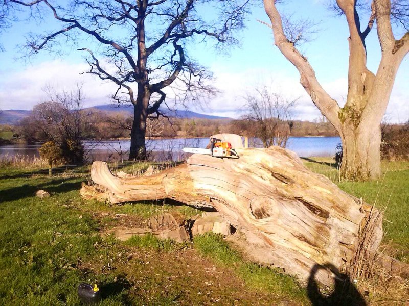

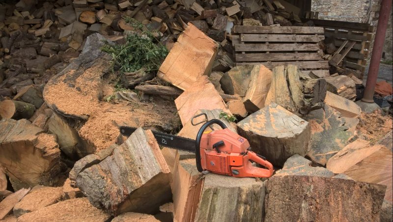

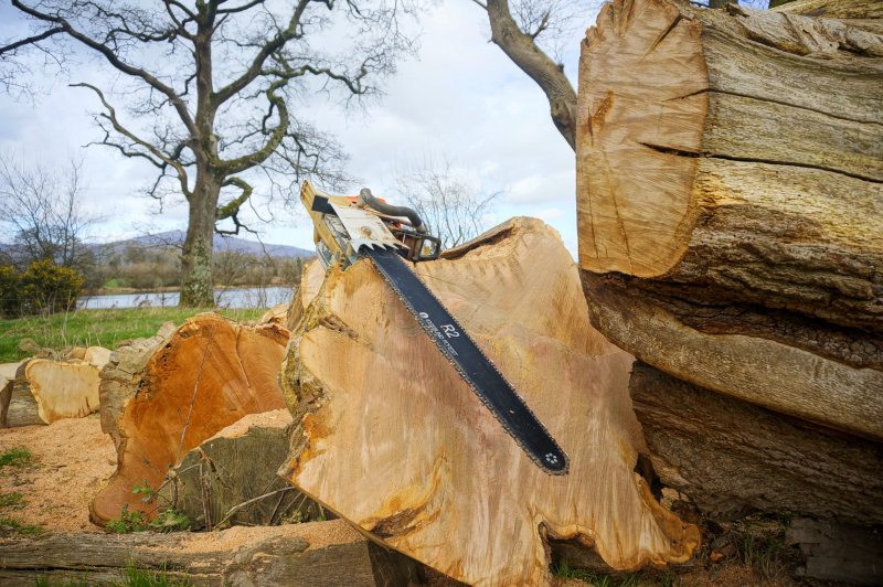

Yeah, it's nice to able to cut and cut and cut. And, frankly, in the field I think full chisel only cuts faster for a few minutes in perfectly clean wood. Outside of that, I think a well set up piece of semi chisel will beat it within a couple of tanks for wood cut. I also tailor my semi to the saw. The 288 can pull a full comp 102 or 98 of semi with stupidly low and dangerous rakers - watch it when you use the back bar. So it removes a load of chips when it cuts. If you look at my 044 vid - that's semi chisel chain in hard red oak, and it is sending out loads of wood per revolution. You can see it kick back at me when I am using it from the right on the vid at :015 ish, and also see the huge ruts in the wood. A smooth cut it ain't, but it will do that cutting all day long:
I started with full chisel on this oak blow down by a lake in a paddock we keep cattle. After that dulled super fast, I went to the 30" bar from the 288 carrying 98dl semi chisel. This is with the very angry ported saw I got from Randy - so it pulled a full comp semi chisel with low rakers in solid semi seasoned red oak. I used the 044 instead of the 288 just to see if it could do it.
this oak has been sittin in a field for years:

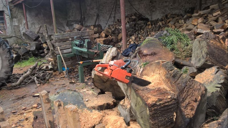

And when I say 'dirty' I don't just mean dirt:
On an estate, you will hit nails and wire.
