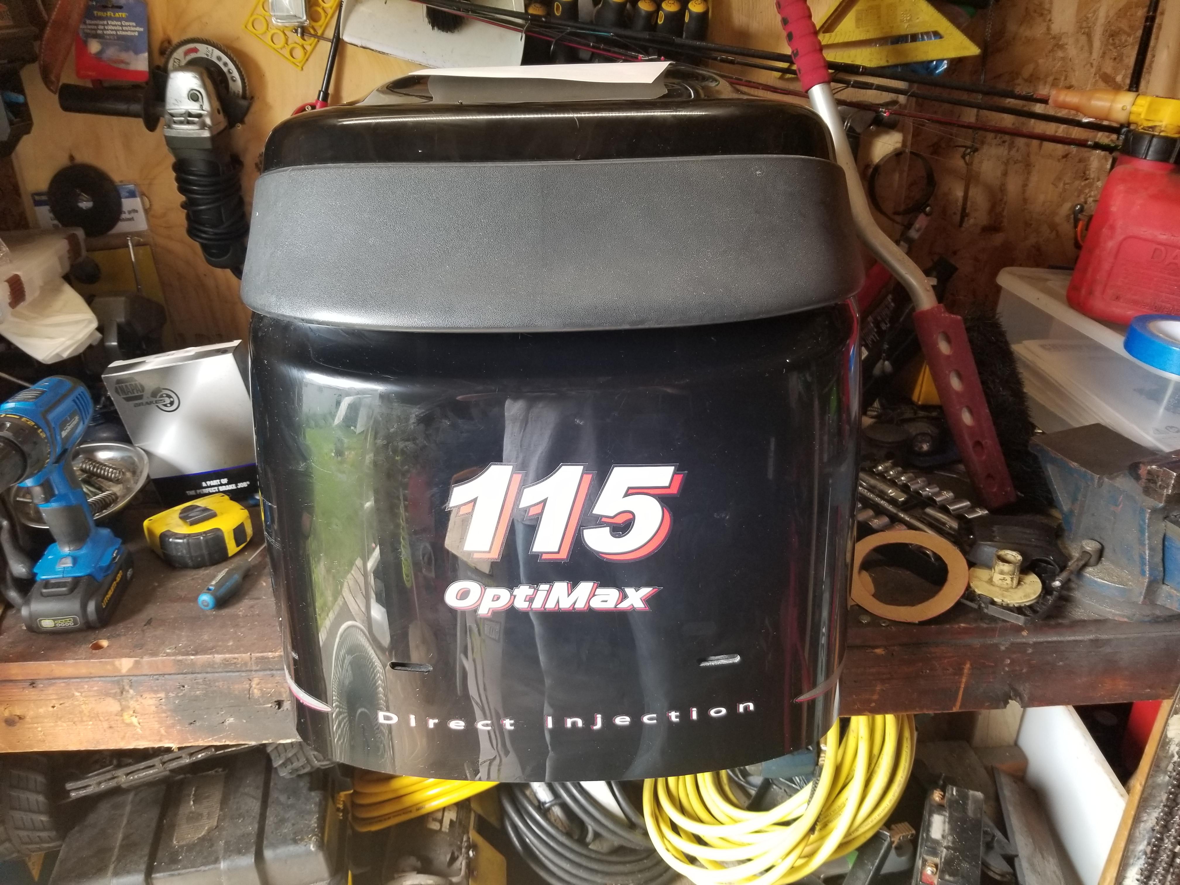

New sticker. She almost ready for water. Change oil in the kicker. Top up the battery and good to go.
What kicker do you have. This came with a 9.9 carbed prokicker. Added Itroll to it and it is well worth it to keep from trying to fight the throttle.

View attachment 297954 View attachment 297955
I got your little brothers to both motors. Kicker is an 8 h.p.
I made my own throttle control with some old rc car stuff. I hated running back all the time to adjust speed.

Were you having trouble cause of them?
Thats dam expensive.
Been chasing my tail on this for a while. No top speed, sometimes doesn't want to come out of hole. Had bad fuel line, coils on lower end of specs, boost pump not building pressure right. Everything I fixed didn't take care of the problems. Bought computer program so I could read problems at home rather than mess with dealer and it showed no problems. Over 500 hours and from the reading I did it needed injectors cleaned and by time I pack up the entire fuel rail and send it off, I was looking at more time and money. Just easier to replace them and eliminate that problem. With just the two replaced it idles better and didn't die so fingers crossed.
