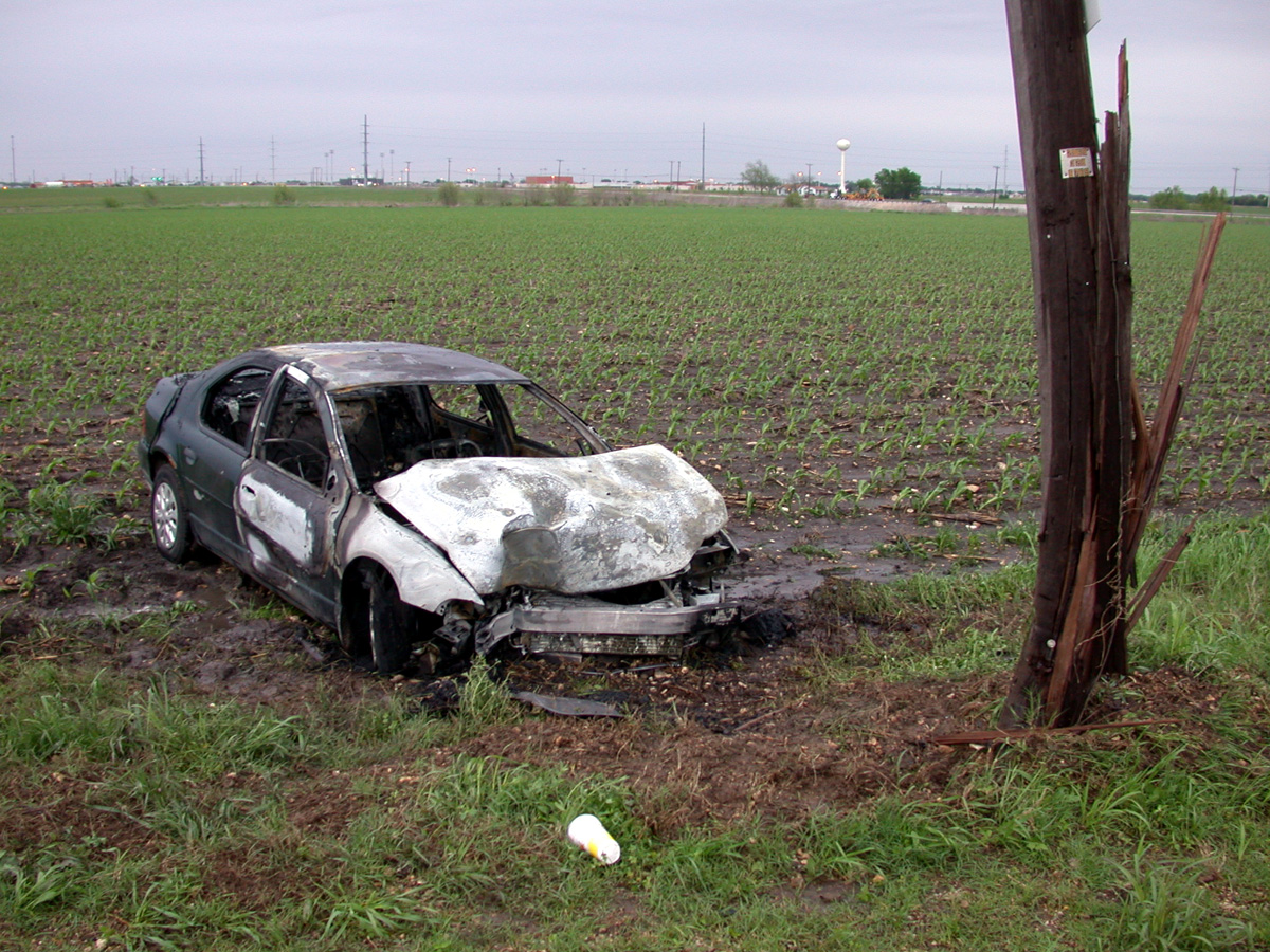

"What kind of idiot would put a pole in the middle of a field?" the driver said.
Another $hitter Chrysler out to the pumpkin patch yay!
