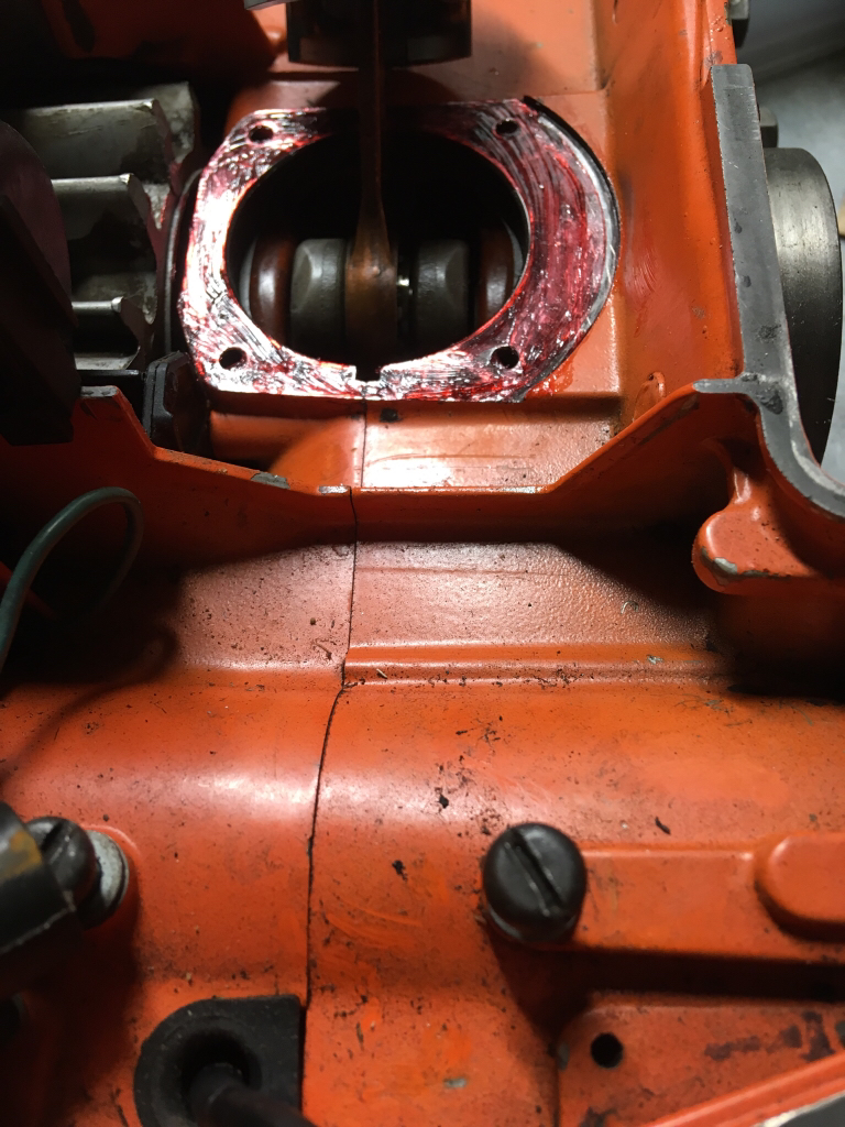

Normally we use bpmr7a
But the last one I did the plug was too low and the piston kissed it. So I measured and the plug was below squish by 6 thousands. Probably ok, but I’m going to use a bmr7a instead.
I also tried different plugs until the spark is aiming at
the chamber.
