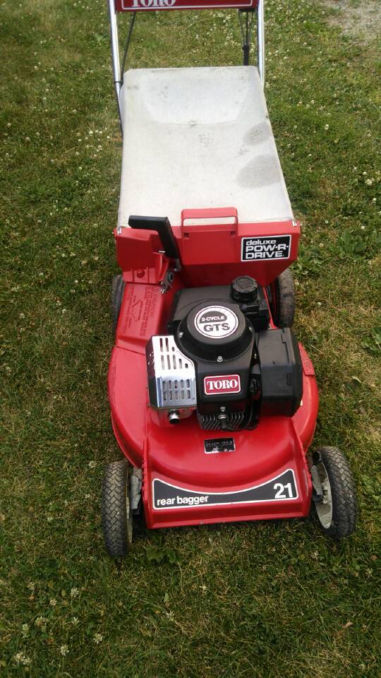

Here is my latest acquire.
2 stroke with self propelled and mag deck. I have 2 of these now and love them!
Is that a Suzuki engine?
That probably the best mower ever made. Id love to find one.
