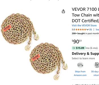

The question was about skidding logs. Logically, longer heavier bad terrain will be hard on any rope or chain. The 1/4" is nice as it doesn't weigh some awful amount. 80 feet (I've 3 twenty-foot segments and a couple of 10 footers) of 3/8 chain is about 120lbs, whereas the same in 1/4" rope is nothing. 1/4" sure seems attractive. Hate to find out when it breaks and whips.
And I can't complain about $5.
I bought this same (40 feet total) a few years ago for a bit less than $90. And more recently picked up the same or close too, at another flea market for near $0. But the weight... OMG. Crazy!
