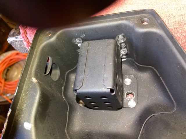

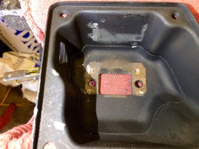

I normally drill the spot welds it'll pop right out

On my unported 066 I just drilled a 1/2" hole through the baffle straight away, and then some much smaller holes on the side of the muff cover, adding a deflector on the left side. Seems to run real well for stock. Not super fast, but lots of grunt.
