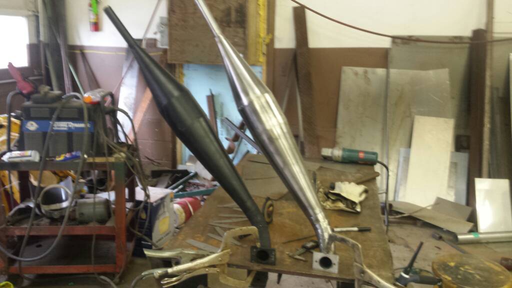

both of these pipes have the same dementions. ..can anyone tell which one is stronger and why?
Sent from my SCH-I545 using Tapatalk
Same overall dimensions or just same total length ? Silver pipe looks bigger in diameter to me ?
If it is bigger in diameter I am going to say it's the better runner.
Correct the silver pipe has a larger header dia and taper all else being the same....it was for a 140 huski racer...turned a wow pipe into a holy crap! Pipe....but I wouldn't have known without building the first one and then trying something different. ...fortunately it paid off....
Which reinforces what we have been talking about as well as confirms what the two stroke tuners book says. More volume leads to better power below the tuned rpm. I'm sure there is a point of diminishing returns, but it seems to be a common denominator.
