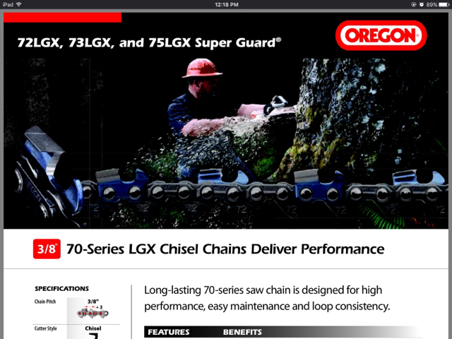

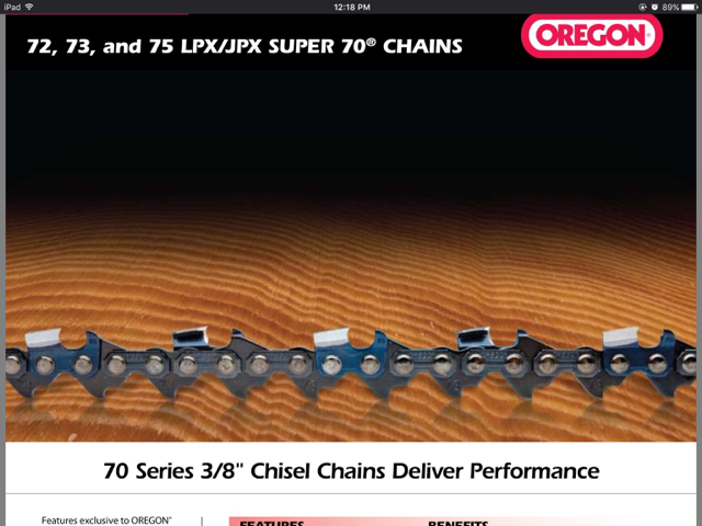

Only difference when I was using the two is LPX has a bumper on the drive link, on LGX it is not there as was stated above. Attached pics for reference.
