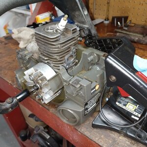

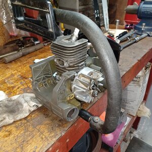

She's coming along nicely , got the new seals / bearings in after cleaning her up . Compression feels much better at this point .

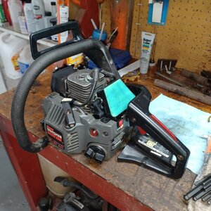

Here's a little update .
The saw quit on me yesterday. I was warming it up prior to fine tuning the hi / lo screws and it just quit .
Would not fire again.
Good spark , plug dry .
Primer bulb was empty and would not pull fuel through the carb .
Fuel was getting TO the carb but not THROUGH it as it should.
I pulled the carb off as this is the obvious problem .
It's a Walbro WT-391 . Completely disassembled and cleaned . While I was spraying carb cleaner into the low speed jet , I found the Welch plug on the metering side was bubbling.
I guess I could have ordered a rebuild kit which would have included a new Welch plug but for $36.00 , I opted for a new one as this one is over 30 years old.
So , on the way is the new carb , oil pump and pickup .
Everything will be here Friday and the weekend weather looks perfect for an indoor project 😡.
Stay tuned.....

Update:
Saw is on the shelf . Very frustrated at this point and before I chuck it into the big blue trash bin , I figured I'll let it sit on the shelf for a while .
It does run but not well .
All the essentials are there .
Great spark , great compression and fuel.
.....cooling off .

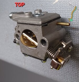

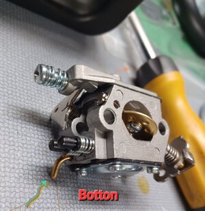

I have this on my bench now , fuel filter is clean & free flowing . Lines are connected correctly.
Pic1 barb is connected to fuel filter / line .
Pic 2 barb is connected to the suction nipple of the primer bulb .
The carb is a knock off from Amazon and I had to modify the choke lever to accommodate the different arm set up. Although it worked smoothly and correctly.
I'm wondering if I should just order a new choke lever & correct carb ($46.00).
Angore
6:40 PM
32348
Mar 30, 2025
139
360
Western NY
I have this all back together (except for the recoil spring I'm waiting on ).
I have the high & low speed screws set to 1 turn out from lightly seated as a starting point .
Is this acceptable ?
I won't see the spring until Tuesday so I can't fire it until then .
