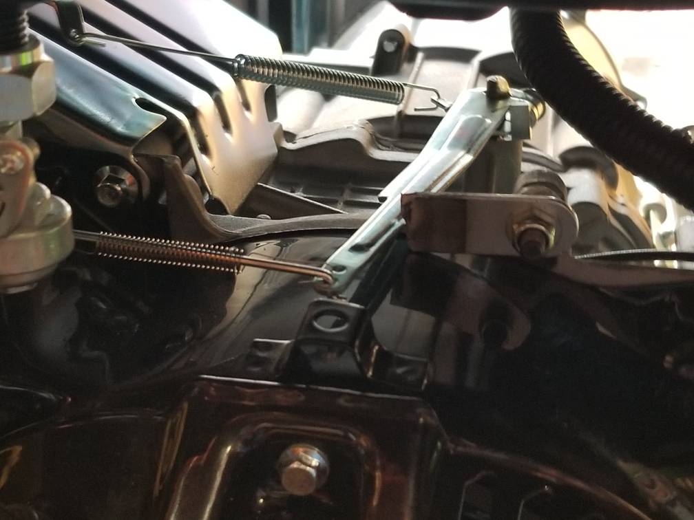

Made a little " idle arm " for the generator so it can warm up and not have to start WOT. I used to sit ther and hold for couple mins and that sucked lol.
Made it with two steps so it can go to fast idle before it goes WOT.
