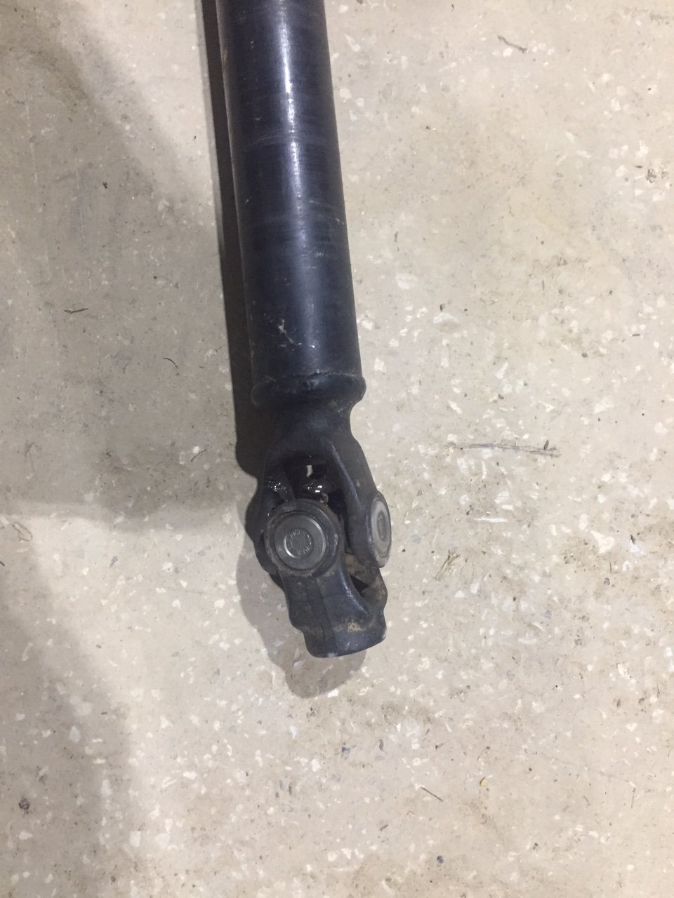

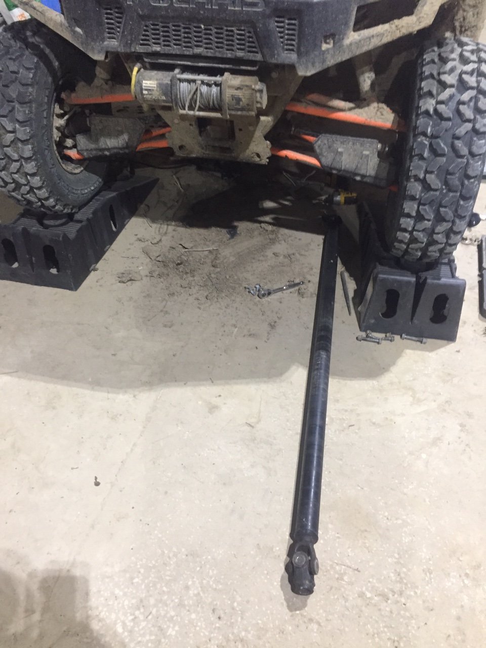

Been working on the Polaris ranger today.
Putting new u-joints in prop shaft
Had to take the skid plate off then take bolts off that hold front diff to slide it forward to slide it off the splines. Dam thing won’t come out.
Got on utube to get help
Have to take out radiator to get front diff out then pull the shaft out the front thru a small square hole.
I don’t think so [emoji848]
There was a 8in cross member keeping it from dropping out the bottom
It got cut off and welded plates back on it to bolt it back on. Dam engineers
All day and its ready to go back together.
