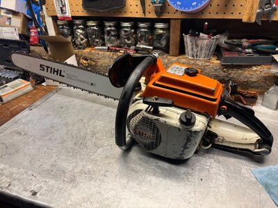

This thing kinda gets me excited for some reason. Not sure why… 041 Super
I have 2 not super fast but lots of torque, the old Stihl dealer I used to go to for parts ect and bs with owner said that was one saw Stihl shouldn’t have made a super version of. The standard 041’s biggest downside was the screws liked to loosen up and then pull the threads out of case and the super just amplified this problem a fair amount he said. My advice is use lots of loctite on it, orange high strength removable would be my choice.
