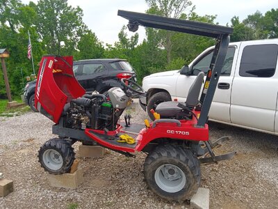

Same here
I have to work on this massey it has a reverse 3 cylinder Mitsubishi diesal engine
The rear now front main seal is bad spewing oil.
I'm trying to figure out the diesal pump mounting if it's keyway or timed some other way before i take it apart.
Info is scarce on these little engines
They want 188.00 for a service manual no binder just loose pages i guess.IMG_20240517_173118.jpg

Same here
They want 188.00 for a service manual no binder just loose pages i guess.View attachment 420806
Couldn't find it on the web. Cheapest find was 10 bucks
https://autoepcservice.com/product/...0gc1715gc1720-series-workshop-service-manual/

Same here
I found my manual here:
Thank the gods that I am a member of a MF facebook group, they guided me to workshop manuals for Perkins.
Tomorrow's plan is to get rid of the radiator and belts, then we will go inside the timing house where we will find all the drives, i.e. to the goods where we can set the engine up on the zero points.
I am going to buy a service tool, a small MF dick that will go in and keep the diesel pump spot on to the pump hub.
Since I hope not to have to do the job again, I buy sealing rings, gaskets, thermostat, water hoses, air filter, etc.
