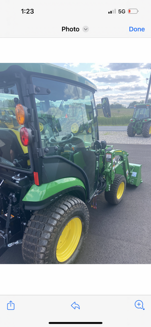

The 2025r is one of the best sellers, looked at the 2032 if i remember right but no cab option. Mine has turf tires too
