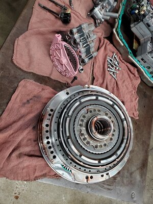

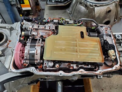

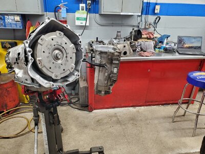

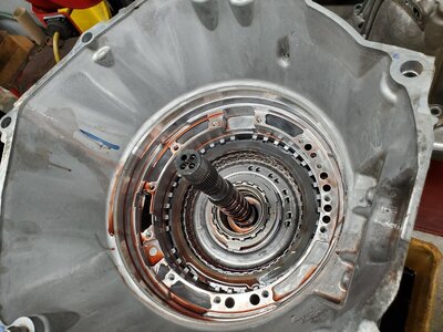

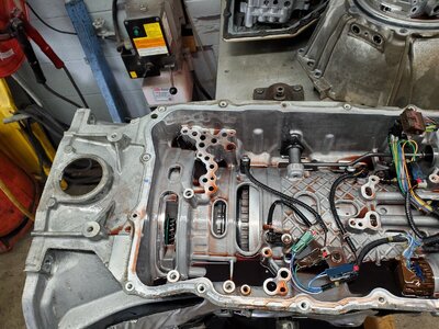

You’re going to need more bench space!Still waiting for parts for the torched 6 speed, so now I'm tearing down a 10 speed to replace the stator support..
Good thing none of the other guys could fo this job...
that is a lot of spensive "stuff" you go thereView attachment 368928
Here's the idler gear in front stator support that causes a whine noise.
It gets a new pump driven gear and stator support.
This is the 4th one I've done.
