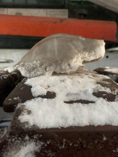

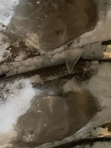

The problem was this running them in the snow
Building up on each pad and got too tight
I’m just glad it snapped the wheel studs and not a axle [emoji106]
Sent from Hoskey hilltop
Due to the open pad on the tracks I have I only have that issue if the snow is real packy.
Once Temps get above freezing I'm forced to either take them off or sometimes loosen them up and occasionally have to take a hammer and knock the ice out.
Temps below 25 though, never have an issue with buildup
